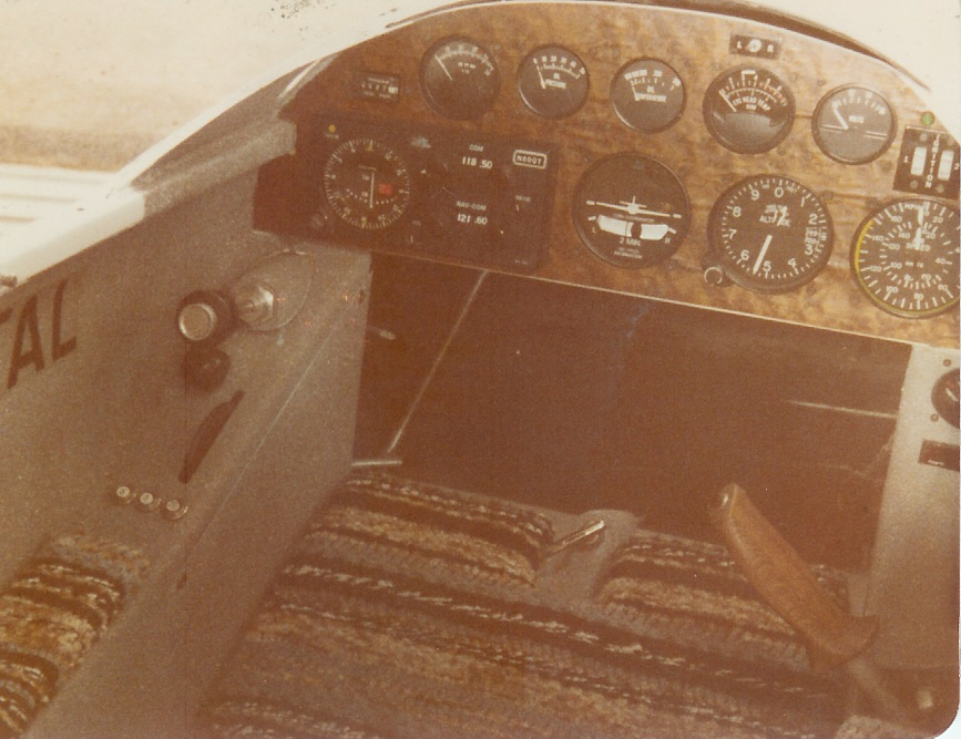

Here’s a story that you might consider:
In the late 80’s my father, brother & I built a single seat Quickie. We installed a vernier throttle in it. She came up to speed very fast on the takeoff roll but at first you really had to be quick with your feet to keep the nose straight. After three successful flights, my father’s friend from WWII came out to see it. He was a colonel in SAC, flying B52’s then, B17’s during WWII. He also had a Navion and a Cub. Due to the fact that he had so many hours in a variety of airframes, my father allowed the Colonel to fly the Quickie after a quick briefing. During the briefing, the colonel was shown that the button on the vernier throttle had to be pushed in order to move it.
The Colonel taxied out. When he applied full takeoff power, the tail began to yaw, as usual. He over compensated several times and then tried to pull the throttle back to idle. He forgot to push the button. In his “panic??” he jerked the throttle and broke it out of the fiberglass panel. At the same time, he went off the runway into the grass. One wheel (the mains were on the wingtips) stuck in the mud, she ground looped and ended up upside down. He was not hurt. It took us 6-months of work to get her airworthy again. When she flew again she had a standard throttle control installed in the new reinforced panel.
The moral to the story:
Vernier throttles are very cool! However, they do not use standard control input which could cause problems in an emergency.
I’m not condemning vernier throttle controls, just sharing a story so you can make your own decision.
Note: The enclosed picture was before we installed plackarding.
