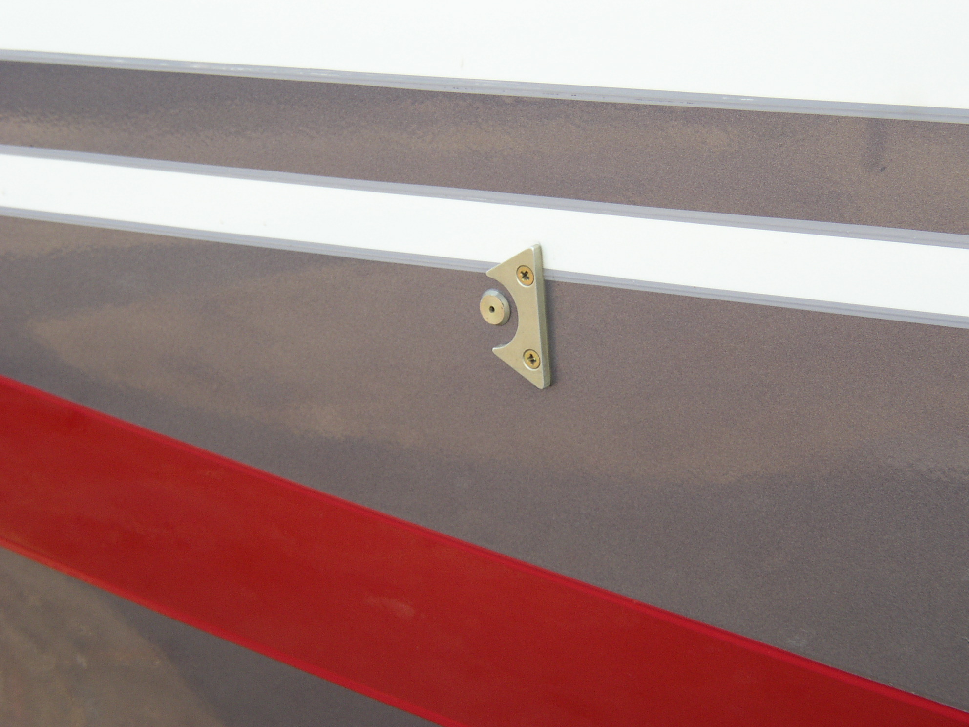

Here is a shot of the solution Dr. Carl Cadwell used on his Lancair IVP.
Sorry to the string and can folks. That was before he started such a
stir with his Epic LT which has led to the 51% Rule rewrite.
These static ports are critical in their exact location and design for
accurate pressure indication. Horseshoes and hand grenades are not
going to do it. You should see what is necessary for RSVM mapping.
John Cox

Tim(at)MyRV10.com
PostPosted: Wed Sep 06, 2006 10:17 am    Post subject: Static port question Reply with quote
Wow, that's the first time I've ever seen such a thing as that.
Very interesting. Maybe tonight or tomorrow I'll stick something
thick on the plane in front of the port like that just to see
what happens. I've never used a hand grenade, but M-80's and
firecrackers can be fun. Wink

PostPosted: Wed Sep 06, 2006 11:44 am    Post subject: Static port question Reply with quote
That's not all that unusual, it seems a bit extreme but it does allow the air to breakup over the actual port. If I recall the oply problems folks have had with the Cleaveland ports (I'm using those) is making them flush with the skin. I think Mike piped in about the face of the port needs to be a thousandth or so above the actual aircraft skin otherwise the hole will act like a venturi and create a negative static pressure as the airflow passes over the static port.

indigoonlatigo(at)msn.com
PostPosted: Wed Sep 06, 2006 12:42 pm    Post subject: Static port question Reply with quote
Not that I really know, but doesn't this venturi happen anyway and isn't
that why there is a port on both sides of the fuselage to cancel out the
negatives and positives of the other port?
My sailplane has a total of six in the tail boom located 120 degrees apart
and they are as flush as they can be.
John G.
From: Rick <ricksked(at)earthlink.net>
Reply-To: rv10-list(at)matronics.com
Subject: RE: Static port question
Date: Wed, 6 Sep 2006 12:43:31 -0700 (GMT-07:00)

Tim(at)MyRV10.com
PostPosted: Wed Sep 06, 2006 1:29 pm    Post subject: Static port question Reply with quote
I think it would depend on the plane and the location for how it
all works in the end. I'm not sure I agree with what Rick said
below though exactly the way he said it. It would seem to me
that if you had a venturi effect giving a little negative
pressure to the static system that you could end up with an
airspeed reading that would be HIGH, since the differential pressure
would be greater....not low. Mine is 6.5-7.5kts low with the
flush ports, and with them sticking out it's more like 4
so far. I'm hoping to figure out exactly what dynamics make it
perfect.
