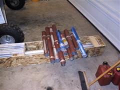

My new spars arrived this morning, and they are much stronger than the old ones. The new ones are marked .065 wall thickness, I guess the old ones were .048. The insert web is also much thicker and the insert is 6" longer. I'm guessing this is all the result of developments that resulted in the heavier later series like the series seven , Vixen and such.
The spars are replacing my rear spars, the fronts are undamaged. I expect they will result in a larger safety margin for integrity as I'm told the rear spars bear a larger portion of the load. I had previously noted the new lift struts are beefier than the ones original to my Model IV-1050.
So, I've now got a Franken-fox with some stronger newer parts. Does anyone think the mismatch front-to-back would be an issue? I will have symmetrey side to side with most ribs original and original spars on the front. I will be re-using one flaperon and have one from a series six that appears to match the old one.
I've attached a photo with the difference in the inserts showing.

PostPosted: Wed Sep 06, 2006 4:02 pm    Post subject: New spars, and different. Reply with quote
Dave,
It is my understanding that the "beefier" lift struts are the major portion
of the conversion from the 1050 GW to the 1200 lb. gross wt. You might want
to check into that if you think you might need the extra payload.
Lowell

PostPosted: Wed Sep 06, 2006 5:01 pm    Post subject: New spars, and different. Reply with quote
Very possibly. Your front spars actually carry more load, since the CP is
only about 30% of the chord from the LE. (Obviously just behind the CG.)
Now I've noticed that my wings are very flexible. (I don't know what size
spars I have, but will measure them when I get the chance.) What will
happen with a softer LE is that when the wings load and deform the local
angle of attack will increase, which will cause them to deform more, which
will increase the local angle of attack... You get the idea. Now it's
possible nothing will happen beyond a certain snappishness to the response.
It's also possible you'll fail prematurely under load, or will have a
flutter problem, or will snap roll with a vicious gust. Your's would be
what we engineers call an "unstable" response. You'll definitely be in test
pilot mode.
If you have to use these spars, reverse them so the softer spars are in
back. Better yet, get the right ones. The tubes should be trivial to
procure. (6061 tubing is ubiquitous.) The inserts a little harder, but
worst case is you have them welded from scratch. (Cut up a tube that fits
the ID closely, then weld on a web, then heat treat.) I'll bet John at
Kitfox LLC has some still, or can tell you the source.

PostPosted: Wed Sep 06, 2006 8:39 pm    Post subject: New spars, and different. Reply with quote
I agree. Stiffer rear spars will make the front spars
seem weaker in comparison causing some divergence and
maybe increasing a chance of flutter.
Test carefully, or change them both.
Kurt S.
