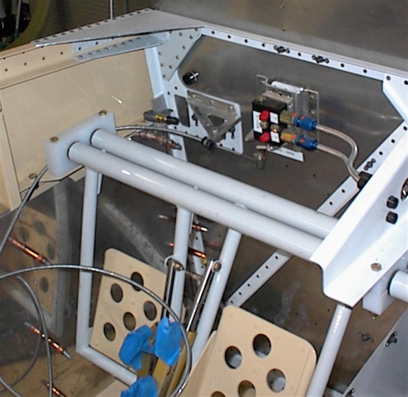

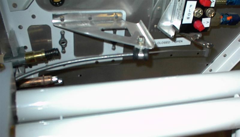

Here is one way. The kit included a bracket for the TruTrak pitch servo that
didn't work as well as the one TruTrak provided with the pitch servo they
sent me so I used it to make the bracket that holds the push/pull cable that
those excellent guys at Spruce sent me.
