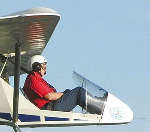

Roger:
My stats are: 6'3", 260# and another issue, size 14 shoe.
Headroom in the FS II is not a problem, even wearing a helmet. (Had an original FS with a solid gap seal where headroom was an issue. Copied a fix that Dennis Souder had come up with for a friend by putting an inverted 10" pie pan on the underside of the gap seal to give a little more headroom. Worked great.)
The issue for me in the FSII is leg room. (At 6'1", this may not be as much of a problem for your friend.) The front seat back rests against the tube that runs side to side of the cage. This tube is the forward edge of the rear seat, but more importantly, provides support to keep the cage from buckling in case of a nose first impact. This layout causes my knees to be very high and restricts the side-to-side throw of the stick.
So far, my fixes have been to: replace the foam in the seat back with the thinnest that I could find and to install a piece of 3/8" brake line toward the rear edge of the windscreen to push the sides out so that I can open my legs to give more room. This also forces my big feet into an open "V" on the rudder pedals ( -\- -/- ) so my toes don't rub the nose cone.
In the attached image (cropped from one taken by Chris Mallory) you can get some sense of the head room, the bow in the wind screen and the position of my knees.
Since I would not likely ever put anything other than gear in the "back seat", am looking at possibly moving that tube a few inches aft in a way that will not violate the integrity of the cage. Would also have to reconfigure the seat bottom to clear the pullies/cables. Have discussed alternatives with several knowledgable people. Work in progress.
All said and done, I feel very comfortable with the current setup and it's worth whatever it takes to fly this FSII.

Thanks to all for the good information. George, the picture was very helpful. Howard, please send me a copy of your set up also. I will pass the information on.
