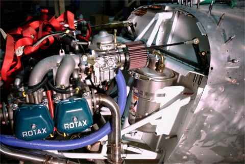

Didn't like cable throttle system,hard to tune carbs.
third 912 I have converted,no problem.
must build all new bell crank system.line up arms with carb levers.
put spring loaded friction on cross tube. Both throttles kept.
Hugh Roberts

How do you counter the thrust inputs on the engine? I would think with this setup engine thrust equates to carbs out of sync. It doesn't take much of a movement on the linkage arm to pull different vacuum loads form one carb to the other.

The throttle settings do change as the engine moves from thrust and roll from torque.
I think if the control rods are parallel in all directions both carbs will change the same amount.
I'm not sure how much they move but I bet it's just a few thousanths due to the 14 inch long throttle rod.
I think the vacuum crossover tube should fix any slight variations.
I use ball rod ends to get rid of any side loads on carb.
Hugh

The easy way around that, if it bothers you, is to attach the throttle rod to the engine block instead of the fire wall.
