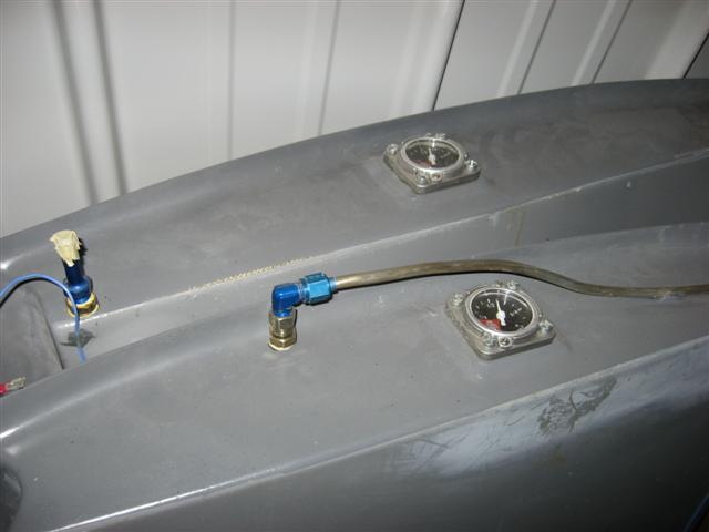

Lynn Matteson
Joined: 10 Jan 2006 Posts: 2778 Location: Grass Lake, Michigan
Posted: Sat Sep 02, 2006 1:04 pm Post subject: Fuel feed problem |
Paul-
In my IV tanks, made in 1994, the vent opening is so close to the top
flange of the tank that it would be impossible to use a 90° fitting,
because you would not be able to rotate it. Where did you hear about
"the preferred 90 degree fitting"?...and what makes it preferable?
Lynn

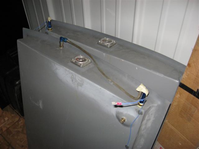

pwmac(at)sisna.com Guest
Posted: Sat Sep 02, 2006 5:53 pm Post subject: Fuel feed problem |
Yes the vent is at the top of the tank under the
flange. One can use a swivel 90 deg fitting. Some
have female threads so one has to use a close
union In any event they are available .Check
hydraulic supply houses. Check the car nut places
like Earls. Attached is a couple of pics foe an
even easier way using AN fittings & a straight
swivel from the hydraulics house + soft Al tubing.
Paul
