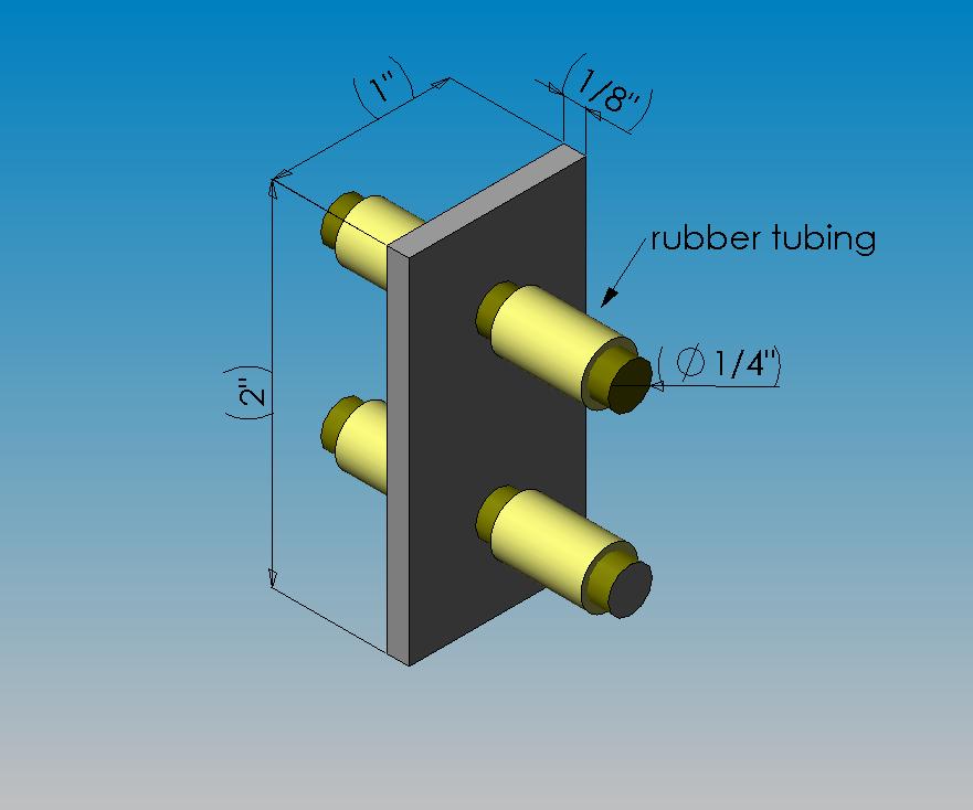

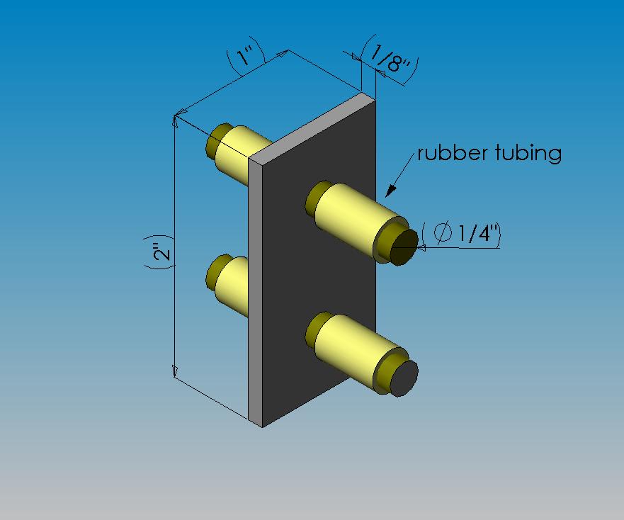

PostPosted: Thu Aug 31, 2006 9:03 am    Post subject: 601 Aileron Lock / Rudder Lock? Reply with quote
I saw a very simple control lock on a 601 at Oshkosh. I can't recall the builder's name, but he was based at Osh. Unfortunately I didn't take a picture of the lock. I drew up a sketch (attached) that should give you the idea. The dimensions are approximate; some amount of 'eyeball engineering' is required. I think he had one on each outboard end of the elevator, and the flaps were retracted with another between each flap and aileron.
Dino Bortolin
Dino Bortolin

PostPosted: Sun Sep 03, 2006 5:02 am    Post subject: Re: 601 Aileron Lock / Rudder Lock? Reply with quote
Thanks Gary, I hope it will be useful. I remembered after sending it out that the plane I saw it on was an HDS, so it has a fixed trailing edge to lock the ailerons to. On an XL you'd have to raise the flaps (and make sure nobody steps on them, ouch!).
