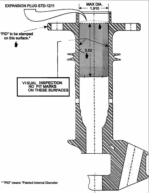

Ralph,
I am not an A&P, but this is based on experience:
Hollow Lycoming cranks have two plug locations.
If a fixed-pitch prop is used, then a ~ 1.910" plug (Expansion Plug STD-1211) goes in the end of the crank opening with no plug in the back of the crank opening. The front plug is convex and is installed by tapping with a hammer so that it tightens in the hole as it expands.
If a constant-speed prop is used, the front plug is not installed but there is a smaller plug installed deep in the back of the crank opening, behind the cross-tube. This plug can be difficult to install because the cross tube must not be damaged. I believe the cross tube is where the pressurized oil from the governor gets to the prop.
Some rear plugs have a setscrew-type plug in them so you don't have to remove the whole plug, just the setscrew when you are using a fixed-pitch prop.
The front and rear plug should not be installed at the same time, else the oil pressure can build up and blow out the front plug, loosing a lot of oil.
Since you see the cross tube, it is setup for a constant-speed prop if the rear plug is installed.
I've included a cross-section picture of the crank in this email, but if does not appear you can see it in: Service Bulletin 505B.
Kevin D. Belue
RV6A ~700 hrs.
RV10 finish kit

Correct on 'most' of this.
Clarification: the 'crossover' tube is NOT where the oil from the govenor enters the crank.....that oil is introduced forward of the crossover tube.....you can see the hole if you look inside of the crank (if it's set up for C/S). The crossover tube, also called a 'slinger' tube or a 'sludge' tube is where oil that seeps through the large front bearing #1/#2 ends up. The tube is slightly off center....the oil enters from both ends of the tube from the surrounding bearing and is eventually thrown out of the CENTER of the tube where centrifugal force will throw any impurities to the inner sidewall of the hollow crankshaft....and the oil will run back down the shaft into the sump. If/when you remove a prop for conversion or whatever you'll typically see a buildup of sludge in this area....don't be alarmed.....just make a little 'hoe' out of some soft .020 and drag it out then clean things up.
Hope this helps.
