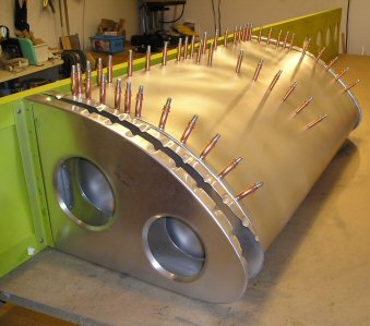

Phil, where exactly do these rivest go?
Got a diagram or photo?
Feel fre to email me directly.
Carlos

I have L section .025" spar cap and spar cap doubler .125 each and spar
web .040 as per drawing 6V4 all of which amounts to more than an A5 can
handle.
regards phil Plumley G-ZENI

>Are you sure? I see the L angle material as .025" and spar material as
>.050" for a total of .075" and the A5 grip length as .312" so they should
>be plenty long. One of us apparently is confused or missing something.
>OOPS, I'm assuming 601XL, but perhaps you are doing a different model.
> Robin, Jasper, AR

Phil, that would be a *solid* rivet. Not very clear, as the drawing says "A5", but I did use
solid rivets on those "L" angles.
If the attached file makes is to the list, you can see it.
Carlos

phil plumley wrote:
> I neglected to mention that I am building a 601HD
> spar web .040 as per drawing 6V4 all of which amounts to more than an
> A5 can handle.
If you look at the detail at bottom center of drawing 6V3, it shows the
spar being riveted together with solid rivets. I'm not sure, but might
this also apply to these nose rib L sections?
RonB
