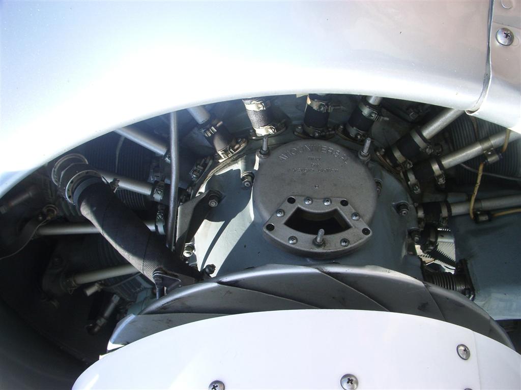

Here is the picture of what Herb was talking about on Jergis’s SU31

Anyone know where to get the case acess that goes on the right side of the case when facing the engine? We had a discussion about oil in the cylinders and fluid lock at OSH. Yeargis has a glass cover on the case that if I understood correctly allows him to pull the prop through after shutdown - while he can see the position of the crank. When the crank stops in the highest 12 oclock position then no oil siphons down into the case. Does anyone in the US know of this mod? It seems simple and easy to install - 3 bolts unless you have a Yak 52TW with electric starter - then this cover is used to mount the starter. It also solves the problem of starting with no oil. I have never heard of it or seen it discussed, yet there it was on Yeargis' Sukhoi and Sergei knew of it too. Any Euro's on the list know of it?

The part pictured is from kit similar to Kimballs clean. The kit was made by Sergio Dallan. I've got a couple here, I'll try to dig out some pics and info and post it to the list.
