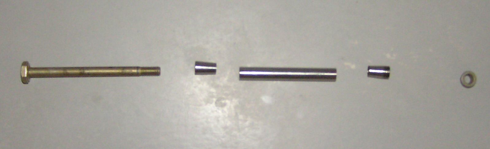

Folks,
So far (480 hours) I haven't had a problem with mine, but that doesn't mean I won't in the future.
Graham Singleton made me couple of pins that have a tapered sleeve at each end that are designed to expand the stainless steel sleeve. I suspect that getting them off again would be difficult, however they look like that they would fix the problem and they are simple to make.
Paul
