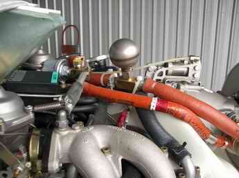

Hi All,
I hope one of you remember the answer to this question. A while back, a long while back, someone posted a picture of a metal bulb installed in the fuel line. I did a search and couldn't find it. I thought it had something to do with pulsations from the fuel pump. Does someone remember what it was called and exactlly what it was used for? Here is a picture.

Is that on a 914 turbo with return fuel line?
I've been flying 912 and 912S since 1994. Never saw one of those
"blubby" thingys before.

Hi John,
This is a 912s with no return line. I thought it might be a pulsation damper?

Hi All,
I finially found the picture and info I was looking for. It was in fact on the matronics home page of things to buy. This is in fact a fuel flow pulsation dampner. It is a stainless steel air chamber that acts like a shock absorber. This reduces fuel flow reading fluctuations.

Roger:
Thank goodness. I don't need to reduce the fuel flow reading
fluctuations on my engine.
The more stuff you stick on an airplane and engine, the more stuff
that can go wrong in the future, especially when you don't want it to
happen.
Ronnie Smith related a tale to me about a 912ULS with 12 hours on it.
Engine destroyed by loss of oil pressure. Seems the customer was
adamant about installing the oil temp sender in line on the oil hose.
Rotax has selected and provides an oil temp sender in the oil pump
where their engineers figure it will work best. Gentleman could not
be talked out of locating his oil temp sender in the oil feed hose.
At 12, or it may have been 17 hours, the connection failed and the
engine was history.
