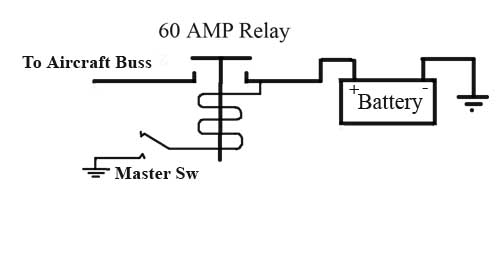

This is how I hooked up a master switch for my Kitfox. The relay is not a starter relay (it would overheat) but the type of relay used in RVs for the extra battery. Just for the the way it looked my master switch is a long toggle with a red light in it of the type they use on tractor trailers. The light draws attention to the switch which can be a good thing if things start to get real busy. The advantages of this hook up are; The high current wiring is all outside the fire wall, the switch lead can be fused at the battery and the relay completely disconnects all power form the battery when the master switch is open.
The disadvantage is the 5 or 6 ounces the relay weighs.

The Circuit diagram sent will allow the 582 to run quite well with the master turned off. that was a consideration I took into mind when I installed the relay. It is only a battery master.
Shutting off the ignition switch will kill the engine. It grounds out the mag coils.
The original builder of my 'Fox put a 20A reset able breaker on the line between the charging circuit and the battery. 20 A is plenty as the charging circuit is only rated at 16A. Also because the exciter coils for the mags are separate from the lighting coils ( charging circuitry ) the charging circuits can be manually pulled if you notice an over voltage on the system . the operating voltage is 13.8V. so if the voltage goes over 15V its time to consider turning off the lighting coils (pulling that breaker), landing at the next convenient field and have the voltage regulator looked at.
Noel [quote]
