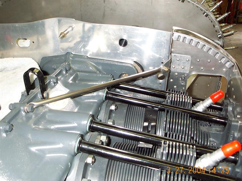

There have been a few busted baffles, but it's hardly a guaranteed failure.
I think it offers better cooling and when done right, will serve you well
for a long time.
See attached. I got the tube reinforcement from Dan C. Knock on wood,
holding up well so far...
