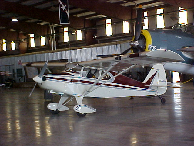

The Piper clipper below was covered and painted in 1999 with AFS/Stewart Systems.
Owned by Dan & Marjie Stewart
This airplane was restored by Dan & Doug Stewart in 1999.
Judged Best in Class Post War Classics Evergreen Antique Fly In 2001 & 2002
Judged Best Clipper
2002 Short Wing Piper Convention - Odessa, Texas
2001 Short Wing Piper Convention - Anchorage, Alaska
1999 Short Wing Piper Convention - Denver, Colorado
