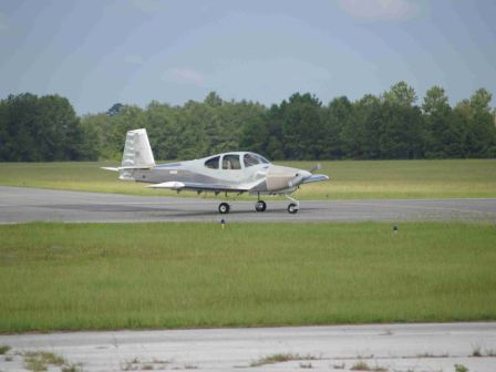

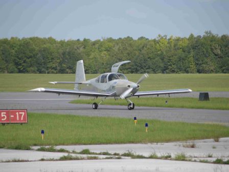

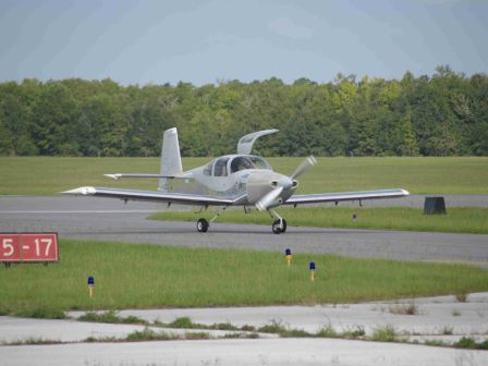

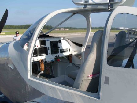

Here are some pictures from N585MR before and after the initial voyage yesterday. No true RV-Grin shots, but I assure you it was there! I put another 1.5 on it today and all is going great. I got the pictures as small as possible, my apologizes if the e-mail is still a little large.
Regarding the high #1 CHT, I swapped the #1 and 3 CHT probes and it turns out the sender must be a little off as it still showed #1 to be a little hotter than the rest. I also trimmed the baffle slightly, climbed out faster and all is good on the CHT gauge.

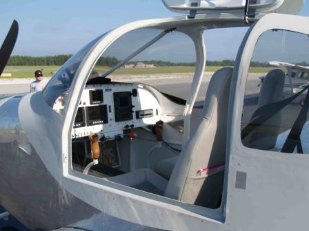

One lesson learned from yesterday was I have 3 EFIS displays, a great Garmin stack and all I could find was the airspeed indication! New panel, new instrument crosscheck. Today went much better although the Dynon hung up at 60 degrees of bank and never fully recovered. I have not installed the updated software (firmware?) so hopefully that will help. I was able to take the time to work the avionics much more effectively, even listened to some tunes briefly.
