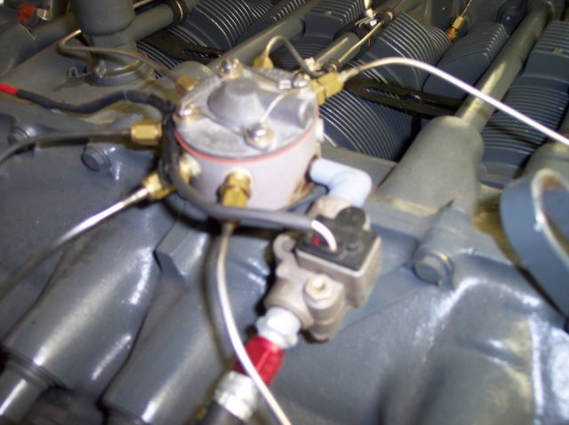

I'm trying to install my Advanced Flight Systems fuel totalizer
between the fuel controller and the distribution block. The
hoses are AN4 and the totalizer has #6 pipe fittings - so I
think that should be AN816-4-6D. Neither Spruce nor Wicks
lists them - any leads on where I can get it ?

gerf(at)gerf.com Guest
Posted: Wed Aug 16, 2006 11:04 am Post subject: Looking for AN816-4-6D |
Thx, but unfortunately no go ...
Looks like an AN912-2D bushing combined with an AN816-4-4D
nipple is the only way to go ...
g
Posted: Thu Aug 17, 2006 7:33 am Post subject: Looking for AN816-4-6D |
Thanks all for your comments - Dan is right about the fittings
between the fuel controller and divider (thanks for the
correcting the nomenclature Dan) the tubing is terminated with
-4 flare fittings. However, the transducer I have (a red brick
about 1 1/2" cubed), I'm pretty sure has 3/8 NPT female pipe
fittings (I need to double check this tonight when I get to the
hangar). I think the intent of the manufacturer of the
transducer was that it would generally go between the high
pressure side of the engine driven fuel pump and the fuel
controller - that's a -6 size hose. Hence the need to reduce
the size from a -6 to a -4.
Posted: Fri Aug 18, 2006 8:33 am Post subject: Looking for AN816-4-6D |
Here's a picture of the transducer. It does indeed have -6
pipe fittings. The fitting in the foreground is -4. Phew,
thought I was losing it.
http://www.gerf.com/images/fuel_flow.jpg
