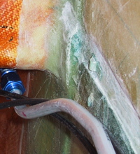

I couldn't get tie wrap bases to stick with anything including redux
(Ampreg) Ended up laying up a sandwich of scraps of bid around a
piece of thin tube covered in release wax Pulled the tube out and cut
5mm strips of the sandwich. They bond on well with redux and the
cable tie goes through the hole. Don't know if attached pic will be
stripped on the list but should appear in the owners forum
Paul

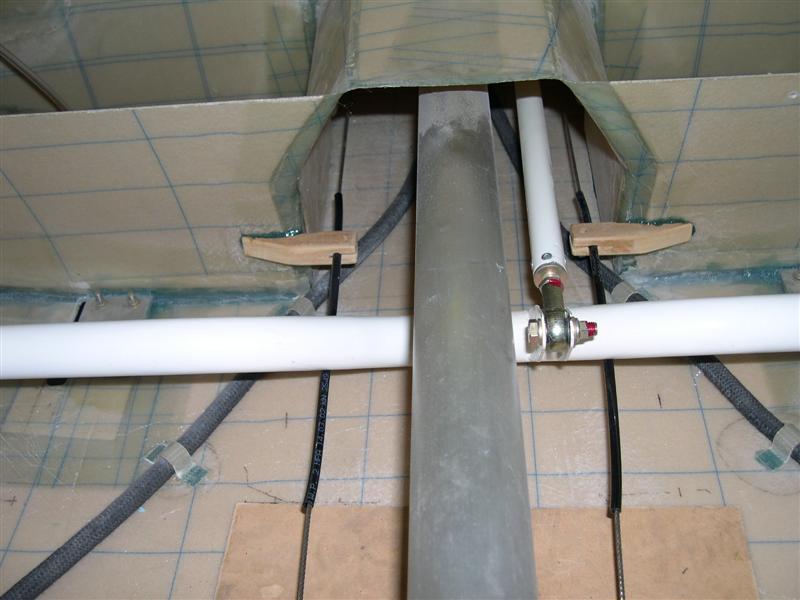

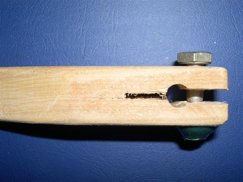

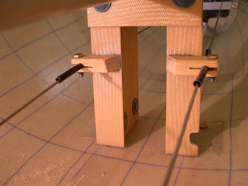

hurstkr(at)growzone.com.a
PostPosted: Thu Aug 17, 2006 2:26 am    Post subject: Favorite cable guide and wire holders? Reply with quote
What is favorite way to adhere to baggage bay ribs? Going through fuse?
Ron,
Attached is what I did. The clamps in the baggage bay did not have their
bolts inserted at the time this photo was taken.
Note that I extended the black tubing back underneath the flap drive cross
tube because the cables just touch the tube when the flaps are down. I have
fitted Graham Singleton's tail wheel mod which elevates the cable at the
rear end more than the factory set-up.
Cheers
Kingsley in Oz.
