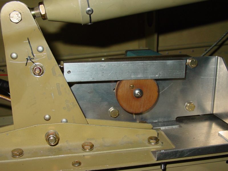

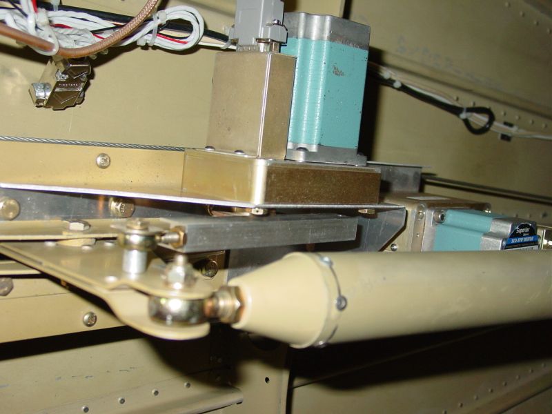

Here's the short answer for that question....
Get the new torque enhancer from Trutrak. I can't say that the
original servo was awful on torque, but I did experience something
that felt like slipping. I just got the newest torque enhancer
design last week. It seemed to do better than the first one.
It's a funky design, but I can see why it would give more torque.
Photos attached (these aren't mine but from TruTrak that I used
to install).
If you get one, doublecheck that the allen setscrews are tight
before you install it.
