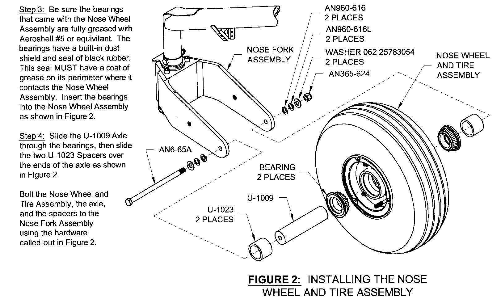

Since some of us are visual people and might not have this part of the
kit yet, attached is the manual illustration of the front wheel attach
for reference.
Tim: along the lines of your set screw suggestion, somebody also
suggested drilling a hole through the nose fork, match drilling into the
axle, and installing a flat head screw to keep the axle from spinning.
This, along with your screws through the spacers/axles would seem to
guarantee the stability of the assembly and eliminate the need for the
washers (and associated trimming). Thoughts?

PostPosted: Fri Aug 11, 2006 7:17 am    Post subject: Front Axle Reference Info Reply with quote
Exactly. I think if you did a proper placement of a set screw from
the fork outside, you could drill into both the spacer and the
axle simultaneously, which would keep them both from turning and
then you wouldn't need the 2 screws I did. I just did this because
I have a whole set of new parts coming and didn't yet want to drill
my already compromised fork...since I have that groove worn into
them. I'm not as confident adding one more hole. If I had brand
new forks, I would have absolutely done it...but not until I've
seen the new spacer.

PostPosted: Fri Aug 11, 2006 7:55 am    Post subject: Front Axle Reference Info Reply with quote
Thanks Bob, I should have looked for the reference diagram in the first
place. This is just messed up on a couple of levels. Tim is definitely
right, without something to lock everything in place, and let the
bearings do their job, something is going to wear eventually. Throw in
dissimilar metal hardness's and it's going to happen a lot faster.
Michael Sausen
RV-10 #352 Buildus Interuptus due to moving

PostPosted: Fri Aug 11, 2006 7:57 am    Post subject: Front Axle Reference Info Reply with quote
Just talked with Vans - apparently the new aluminum spacer part number
is U-1023, not sure what the original stainless steel spacer part number
was. They said aluminum version has been shipping in finish kits for a
little while now. They are sending me a pair of the aluminum spacers at
no charge. Nobody seems to know why a letter or service bulletin
wasn't issued.

PostPosted: Fri Aug 11, 2006 8:00 am    Post subject: Front Axle Reference Info Reply with quote
In our business we have a lot of assemblies with dual bearing
applications. High speed rotor fans and chipper rotors, but also some
low rpm wheel hubs.
Our experience is that the best solution to all related problems with
shafts and bearings, is if the bearing races are trapped on both
sides and the stack up of spacers inside and outside of the bearings
are loaded so the races and spacers have no inclination to rotate.
Rather than an internal spacer we would typically machine a internal
step on the shaft (Axle).
The spacer or step on the inside might be a problem in standardizing if
there is much variability in wheels. It would be a better approach than
a spacer however if the wheel hub doesn't provide enough dimension for a
separate spacer becaus it doesen't take much of a step to effectively
stop the race.
The difficulty with a set screw or bolt, could be one of structural
integrity, but maybe even more so getting the perfect positioning of
those holes. you can still end up with too much play or too much
pre-load on the bearings.

PostPosted: Fri Aug 11, 2006 8:19 am    Post subject: Front Axle Reference Info Reply with quote
The old part number was the same, U-1023....they just changed the
piece that they were sending from thin stainless to thick
aluminum. I haven't seen the new parts first-hand yet, but
I understand that they are shipping new kits with the new ones.
Me being kit # 170, and only 42 flying right now though, point to
the fact that there will be at least 130 people affected.

PostPosted: Fri Aug 11, 2006 8:31 am    Post subject: Front Axle Reference Info Reply with quote
You point out one of the flaws I saw with my current fix, that
I saw before I did it. If you pin the spacers to the axle
with screws like I did, you need to ensure that the spacers
would still be able to be tightened on the bearing, and
that means you'd have to tighten the assembly before inserting
the screws, because the spacers will move until you're done
torquing the axle bolt. This means the hole in the spacer
side will probably have to be a pretty loose fit. So it
is far from perfect. Attacked from the outside of the fork
it would be better. And you're right, things won't rotate
until there is some severe rotational load, and at that point
those screws could snap....of course, at that point your
spacers are spinning again too, so you have bigger problems.
Structural integrity is a big one, but on this particular
spacer and axle, there isn't really anything being stressed
that would crack. Drilling through the fork though would
be one to think about thoroughly to make sure you consider
the forces involved...that's why I am hesitant to drill
mine that are already possibly weakened.
You absolutely have the right points though in your
first couple of paragraphs....ideally we'd trap the
races, and have stepped shafts. I would think that
this wouldn't be too hard to do. With luck maybe
we'll either see a future change from Vans, or we'll
see someone like Mike at Cleaveland come up with an
entire retrofit kit that will provide a better solution.
I will be satisfied when I am assured I'll never wreck
another fork and can hopefully keep the inner bearing
race from spinning...at that point I hope my nosewheel
sees so much more air time than ground time that
it just lasts as long as the plane does.

Tim,
Actually it's a little more complicated than that. Kit numbers only
reflect where you were in line when you ordered the tail kit. Any other
kit would be dependent on the date it was shipped from Van's. I didn't
ask exactly when they started shipping the new version of U-1023.
Bob

dlm46007(at)cox.net
PostPosted: Fri Aug 11, 2006 9:29 am    Post subject: Front Axle Reference Info Reply with quote
I just spoke to Van's and they switched to aluminum early in the finish kit
shipments so check your spacers before calling.

I tried to order the spacers from Van's just now. they insisted that they only shipped out very few stainless spacers before they switched. thus they wanted to charge me for the new ones. It took some talking to convince her that even though the part # were the same I had the SS ones.
Left Hand meet Right hand
Gary

I have 40355 and still the SS spacers, they are no good!

Perhaps a few people can identify when they got their Finishing kit,
and we can figure out the approximate timeframe from that.
Mine was I think March or April 2005 if I remember right, so
at least at that point they were SS.
Anyone get their finishing kit last year in August care to pipe in?
