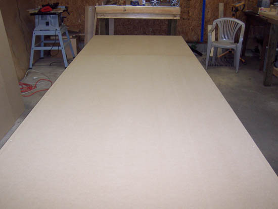

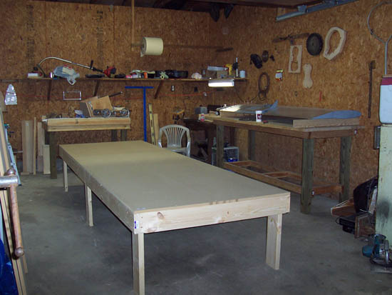

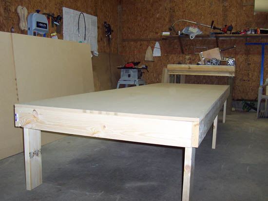

PostPosted: Fri Aug 11, 2006 5:50 pm    Post subject: 12' x 4' Workbench Ideas Reply with quote
Yep... I agree... Here's my table made with 2X6's and an MDF top... It
works really well..
Randy
