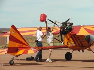

To transfer fuel from the can to the aircraft I use 6 feet of 1" OD X
7/8" ID vinyl hose. Can pick it up at anything large hardware store,
or try Lowes, Home Depot, etc.
Been using this system since I learned about it from a friend who flew
an S-1 Pitts. Was walking by his hanger one day, where he was
standing off from the airplane, holding the gas can up and
transferring fuel from can to tank via the 1" hose.
Wish I knew how much fuel I have transferred this way.
WillUribe(at)aol.com

--> Kolb-List message posted by: "John Hauck"0 <jhauck(at)elmore.rr.com>
Hi0 Mike S:
To0 transfer fuel from the can to the aircraft I use 6 feet of 1" OD X0
7/8"0 ID vinyl hose. Can pick it up at0 anything large hardware store,
or0 try Lowes, Home Depot, etc.
Been0 using this system since I learned about it from a friend who flew0
an0 S-1 Pitts. Was walking by his0 hanger one day, where he was
standing off from the airplane, holding the gas can up and0
transferring fuel from can to tank via the 1"0 hose.
Wish0 I knew how much fuel I have transferred this way.
john0 h
mkIII0

I use the same arrangement, red poly tank with loop handle,
vinyl hose fits perfectly over the stub on the tank cap. As I0
remember, the tank
had some kind of a self-venting device on it which I removed
to clamp the hose on. I drilled a very small hole in the handle
for the vent. My tanks are in the standard MkIII location so I don't
have to lift far for gravity to do the job.
BB
