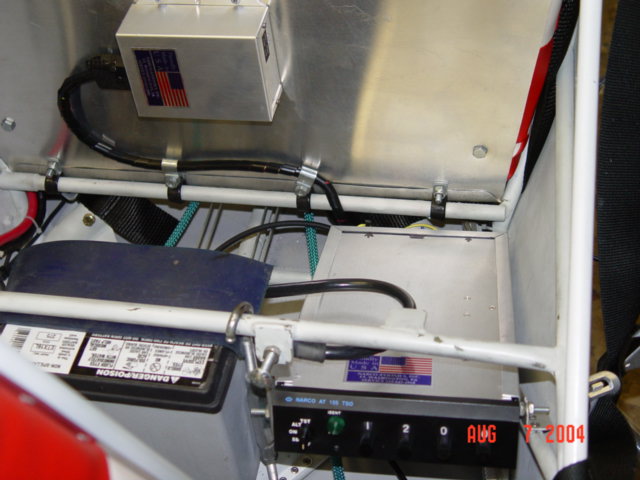

Here is a link to some installed pictures of the battery and hotbox in a
FSII.
http://www.bcchapel.org/pages/0003/FSII%20Hot%20Box.html
Ground the battery to the airframe, and ground the engine to the airframe.
If you put the battery where we have ours, or anywhere close to the rear
seat, it will work out ok because it will be close to the cg.

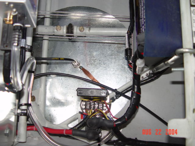

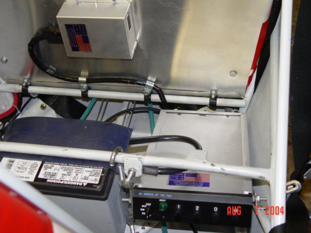

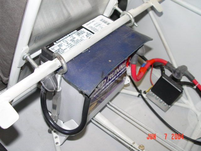

Here's some pictures,
I had to bend the cross tube "up" a little for clearance...I used a
bottle jack...
Although I'd rather have it in the nose of the plane
( I'm carrying 16 lbs of dead weight up there )
Gotta Fly...
Mike ( from the KMA list )

PostPosted: Fri Aug 04, 2006 1:40 pm    Post subject: Re: Kolb Reply with quote

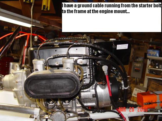

kma
 Filesize:  60.89 KB
 Viewed:  515 Time(s)
