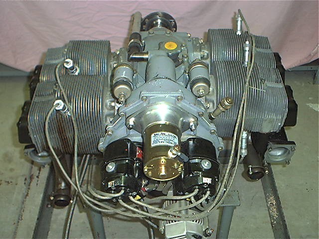

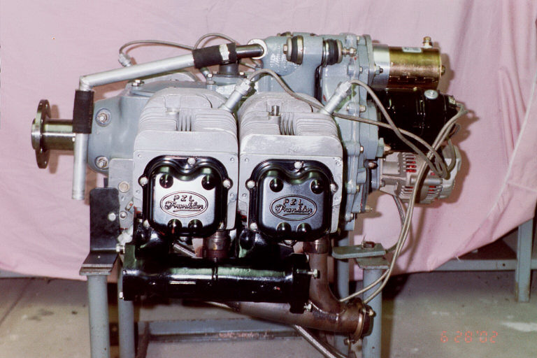

PostPosted: Mon Jul 31, 2006 5:34 am    Post subject: Engine for 601XL Reply with quote
The subject of the Franklin engine came up in a unrelated conversation between myself and an A&P friend a few weeks ago.  He stated to me then that the Franklin engines are "throw away" engines, meaning when they need to be rebuilt, you just throw it away and buy another...  He said they didn't even make an overhaul kit for it...  Whether or not this is true, I'm not 100% sure...  If you are planning to buy a Franklin, this might be something to check out first..
Randy

PostPosted: Mon Jul 31, 2006 7:35 am    Post subject: Engine for 601XL Reply with quote
Can't say I agree with your A&P, there are plenty of sixty year old Franklins still flying in Stinsons, Seabees & Bellancas, newer ones flying in Maules since the early seventies.  The biggest question is whether they are still in business.  This is all hearsay:  PZL in Poland who made Franklins was supposedly bought by P & W.  They didn't intend to continue the piston engine line.  Has it been sold?  Have they continued?  I don't know.  I have a PZL 125 4 cyl on the shelf here at the plant.  We bought it to re-engine our '59 C150.  Everyone who has NEVER spoken to the FAA at our airport has told us that "field approvals" are "impossible" to get, so that project is on the back burner until we get some more time.  I have attached some pics of the engine since most have never seen one.  This one has a earlier version sump.  I have a bit of info regarding these engines and would try to answer questions, but please ask one question at a time, I'm at work and can't write a histoy.  Regarding their design they have many interesting features including a fluid vibration damper built into the flywheel within the accessory case.
Randy L. Thwing, Las Vegas
Subject: Re: Re: Engine for 601XL
Randy
