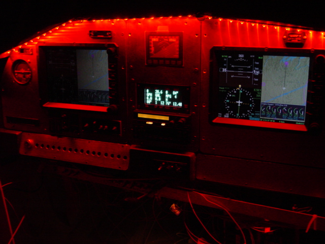

PostPosted: Thu Aug 03, 2006 8:15 am    Post subject: MPJA speed control Reply with quote
Hi Ernest,
Yes, I'm using the MPJA pwm speed controller for dimming LED's. In the
attached jpg. you can see the string of led's across the top of my panel
which are controlled by a single MPJA speed controller. I too
repositioned the potentiometer with a remote unit of higher quality. All
of my circuits were configured from the manufacturer to operate on 12v
as the MPJA pwm speed controller is designed to operate a 12v motor.
Works great with no noticeable flicker.
Mark S.
