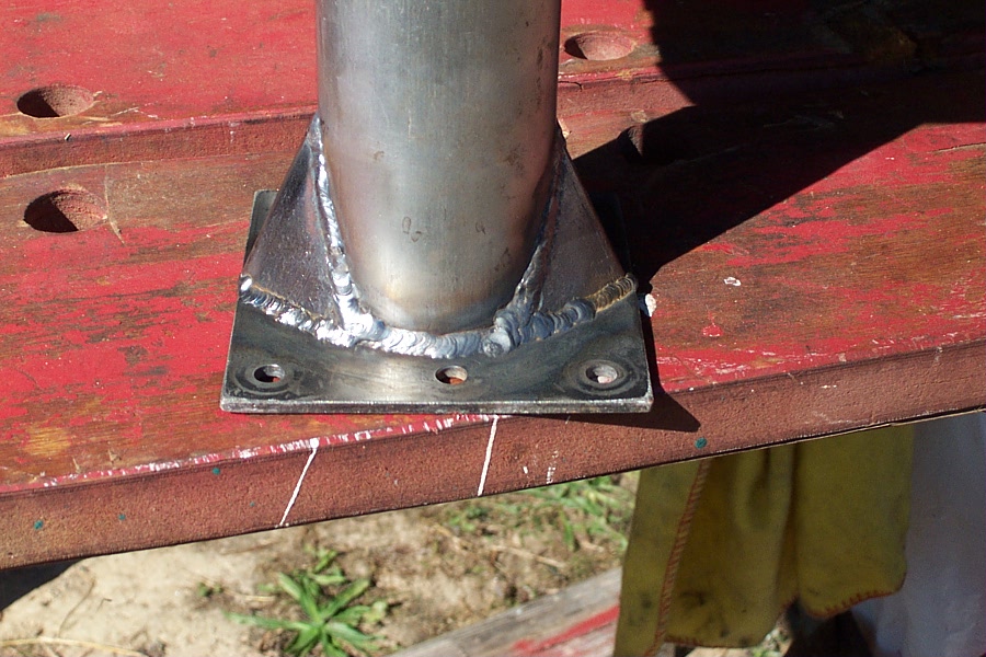

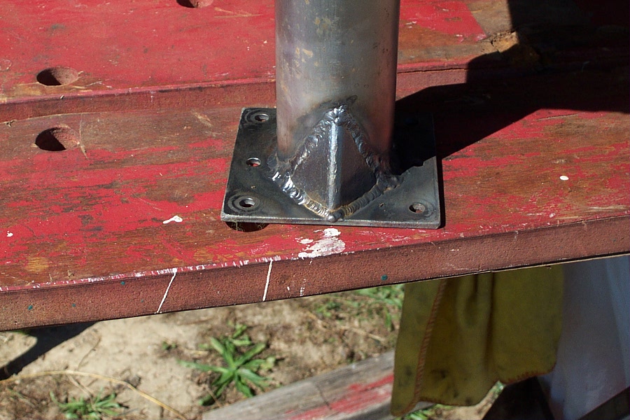

Jeff and Larry,
I shared your concern about the gear plates after reading of several
that separated from early 601s. My solution was to weld a triangular
gusset to front and back of the strut to plate junction. It increases
the welded area a lot and hopefully will prevent a problem from
occuring. I am enclosing two shots of my fix. Hopefully the pix aren't
too large for dialup users, but the detail may be helpful.
The fix isn't hard but removing the gear assembly from the wings is a
pain in the &$(&#*. Don't plan on doing it again any time soon.
Ron

PostPosted: Fri Jul 28, 2006 4:54 pm    Post subject: strut coating Reply with quote
ron dewees wrote:
> Hi Larry,
> Thanks for the comments. I got no feedback and wasn't sure the pix
> got attached to the post. FWIW my gear legs were nickel plated, I
> was told by the guy I got the project from. I only have 140 hours on
> the legs so can't say they will last forever or not, but they take
> the bounces of a turf strip just fine. I also made a nylon plate
> with a hole in it to act as a bearing inside the upper strut mount on
> the wing but am not sure it's a cure all for dirt or wear. My plane
> is a taildragger so it gets possibly more weight per gear in a
> landing than a tri gear model.. The bungees are holding up just fine
> and it still sits at the same "neutral" spot as when I first hung the
> motor
> I took a good look at the ZAC welded plate at the strut and the
> weld is beautiful, but perhaps a little shallow. Jim Pellen's 601HD
> that lost a gear leg failed at the weld, altho a thicker plate than
> our 1/8 inch may have helped, or at least encouraged the welder to
> lay a thicker bead on the joint. I used aprox 3/16" angle iron from
> a bed rail to make the gussets and put a heavier bead on the pieces
> so I think it will strengthen the whole area. Time will tell. I
> don't see any reason why the whole strut couldn't be plated if you
> want to. It's all steel. I just sprayed mine with zinc chromate and
> a silver primer that matches the gear legs.
> Good luck.
> Ron

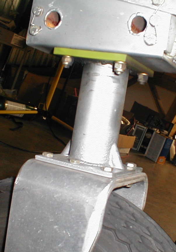

PostPosted: Wed Aug 02, 2006 1:34 pm    Post subject: Re: strut coating Reply with quote
Another 2 cents.....
My gear legs were originally powder coated. I WOULD NOT recommend powder coating gear legs. The powder coating on my gear legs added significant thickness, did not wear as well as I expected, and was not as uniform as the original surface. My gear had significant stiction (initial resistance to move, term frequently used when discussing motorcycle forks).
I believe the powder coating may have contributed to my gear leg failure on 12/16/04. I had 318 hours and 405 landings at the time. My replacement main gear legs have a extra supports added (see picture) and were hard chromed. I also added Nyoil bearings, from Zenith, at the top and bottom of all three gear legs when I did the repairs. The replacement gear operates more smoothly than my original gear.
My failed gear leg looked very much like the picture Tim Perkins posted. So much in fact that I checked my pictures to see if Tim had some how posted a picture of my gear!
Roy
N601RT: CH601HDS, nose gear, Rotax 912ULS, Arplast PV-50, All electric, IFR equipped, 598.4hrs, 686 landings
