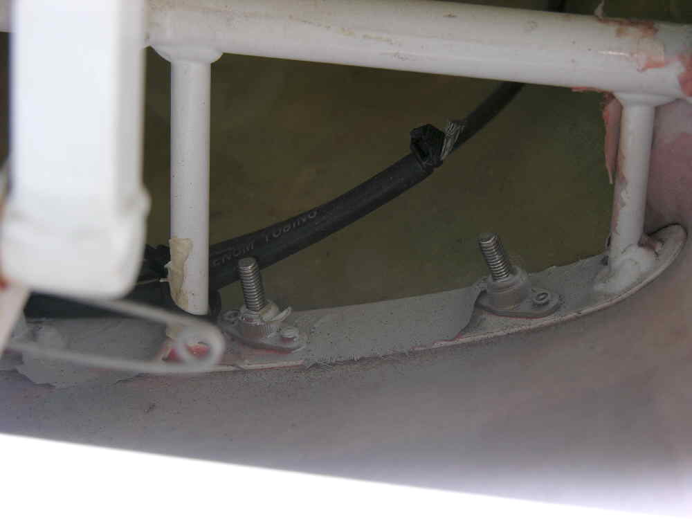

dhkey(at)msn.com
PostPosted: Sun Jul 30, 2006 3:15 pm    Post subject: RivetNuts for the nose cone Reply with quote
I want to be able to take the nose off without drilling everything out. Do
you have photos of the AN366F anchor nuts being used?

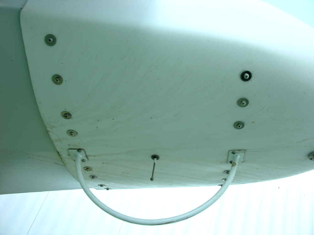

PostPosted: Sun Jul 30, 2006 6:04 pm    Post subject: RivetNuts for the nose cone Reply with quote
I just went out and took a couple of pics. Let's see if I can still attach
'em here......... Sorry - Vamoose needs a bath, but that'll come.
