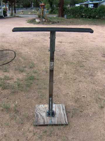

A couple of guys asked for pictures of my "T" stand.  All it is is a stand with felt on top.  It telescopes up and down with holes drilled into the stem and locked by a pin (or bolt or ???).  As it stands, it is 51" high, which is just right for my wing.  When rigging my MKIII, I position the stand a bit inboard of where the outboard tip of the wing will be.  Then I swing the wing out and rotate it into "flying" position and work the inboard edge into the lip of the fuselage.  When it pops in, I hold the wing with one hand and finish positioning the stand with the other.  Then I rest the wing on the stand and hurry over to the fuselage end and put in the pin.  After that I lift the wing a bit with my shoulder and hook up the strut.  Then when the aileron and flap pushrods are hooked up it's a done deal.  Piece of cake.
I don't plan on doing much flying for the next week or so because we're getting rain - Arizona's "monsoon" (Ha!) season.  But if anyone wants more pics of something, let me know and I'll take them next time I fly.

Thanks for the picture... it speaks a thousand words, and although
you may think it too simple to warrant a posting of the image, I
hadn't thought it would look like that, so, I'm really glad you did!
Again, thanks!
-- Robert

Hi ,
very neat. I had envisaged something more like a step ladder to accomodate rough ground. I assume from the small flat base that you usually rig on a flat surface.
Pat
