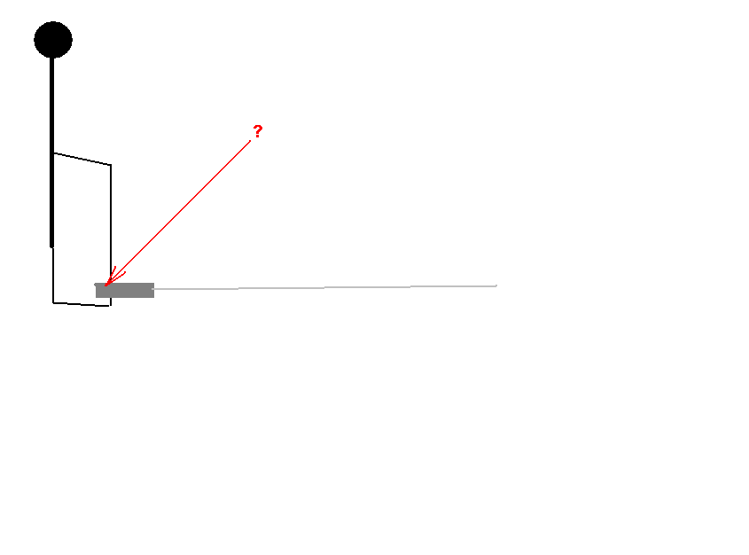

There is a tiny hole that I'm suppose to use to connect my throttle stick to
the cable. I guess I'm suppose to use a safty wire or a cotter pin. What
have you guys done here?
Almost Done David

WillUribe(at)aol.com
PostPosted: Mon Jul 24, 2006 9:16 pm    Post subject: Throttle to Cable Question... all models Reply with quote
 I use a cotter pin

John Cooley
Posts: 17
Location: Lucedale, Ms.
PostPosted: Tue Jul 25, 2006 3:01 am    Post subject: Throttle to Cable Question... all models Reply with quote
Cotter pin for me too.
Take Care,
John Cooley

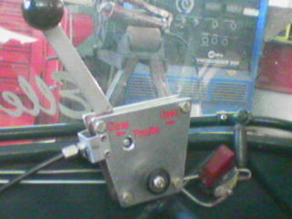

ElleryWeld(at)aol.com
PostPosted: Tue Jul 25, 2006 8:30 am    Post subject: Throttle to Cable Question... all models Reply with quote
That don't look like a good idea  Your throttle cable is going to fail sooner or later because of where it is bending in the pic
Dont ask me how I know this
I replaced the throttle with a Quadrant from CPS California Power Systems I did a little mod to it but it is much better and less wear on the cable
heres a pic of it
Ellery in Maine

eagle1(at)commspeed.net
PostPosted: Tue Jul 25, 2006 8:57 am    Post subject: Throttle to Cable Question... all models Reply with quote
A cotter pin comes with the kit for that purpose, However I would recommend
that you use a piece of piano (steel) wire bent over on both sides. The
reason being, If that LITTLE cotter pin breaks or wears out your throttle
goes closed.
Just my thoughts.
Az Bald Eagle
PostPosted: Sun Jul 30, 2006 1:16 pm    Post subject: Throttle to Cable Question... all models Reply with quote
| Thanks,
| Almost Done David
David/All:
I drill out that tiny hole to 3/32". Then use a 3/32" A&E clevis pin.
They are intended for this purpose. The cotter pin is not.
There was a gentleman that broke his Twinstar because of a broken
cotter pin in the throttle.
The 3/32" clevis pin can be purchased at most aviation hardware
sources.
PostPosted: Sun Jul 30, 2006 1:24 pm    Post subject: Throttle to Cable Question... all models Reply with quote
fail sooner
| Ellery in Maine
Ellery/Gang:
I have found nothing wrong with the standard Kolb throttle, which I
have used for a good period of time.
I do replace my throttle cable every 500 to 600 hours as a precaution.
I also replace the cotter pin with a 3/32" clevis pin.
mkIIl
