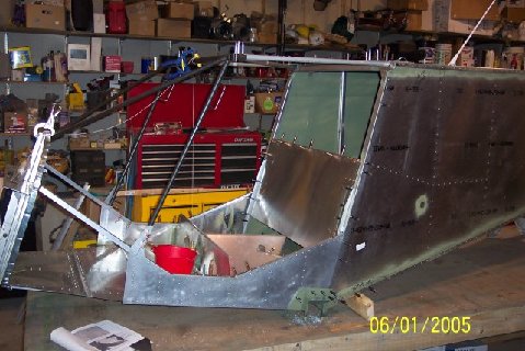

Bob,
I plan to put in a static port too.  Where did you locate yours?  My plans are to put it on the left side just in front of the door.  That's were it was on my Cessna 175 and it worked well.
Any thoughts appreciated.

Tommy
This is where I put mine, if I remember it was suggested by Gary Gower. If I had to do it all over I would get a pitiot/static combo tube and not use the one from Zenith
