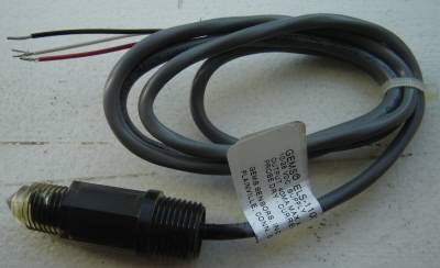

Have you considered using a GEMS sensor connected into the line coming from the pump?  The ELS-900 is smaller than the ELS-1100, and might be a better choice for your application.  Seems simple enough to implement using a tee fitting.  The GEMS sensor is solid state and uses a prism to detect the presence/absence of liquid.  That could control a relay which would control the pump.  You can pick up these sensors off ebay for under $10/ea.
Mark S.
