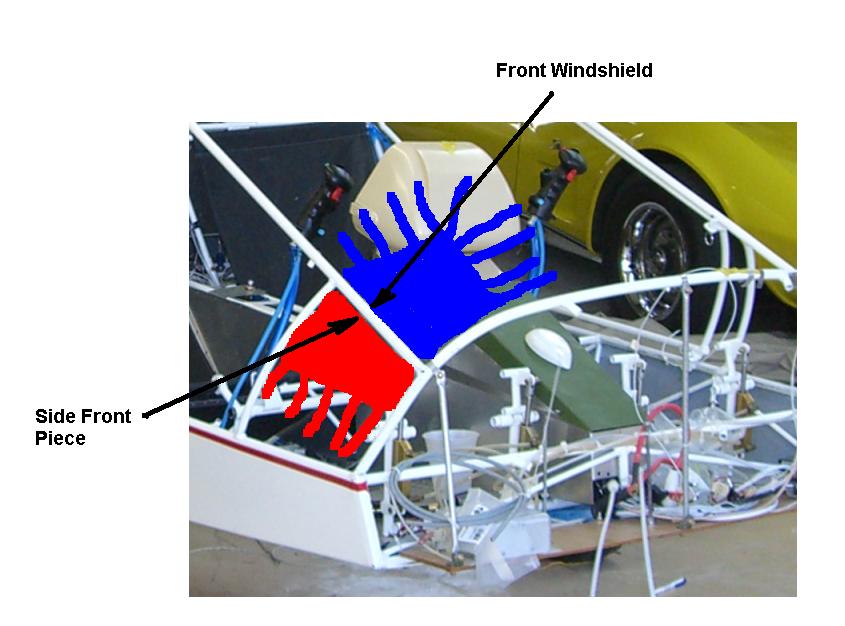

There is one tube where two pieces of Lexan join(see attachment). Am I
supposed to put two rows of rivets on that tube or overlap the lexan. Was I
suppose to cut the windshield lexan with the front tabs in it and run it
down the sides in the front. If someone has a photo that would be great too.

I riveted the windshield in place first. The side window I positioned
the top just under the edge of the windshield and the tube, riveting
only the front edge back edge and the bottom of the side window
Uncle craig

I installed the side window temporary then overlapped the windshield and used one row of rivets to attach both to the tubing.

I installed mine the same as Jim. One row of rivets.
Larry Tasker
Mklllx 582

Thanks, I guess I'm going to go with overlapping the lexan. I'd like to see
photos of your xtras!!
