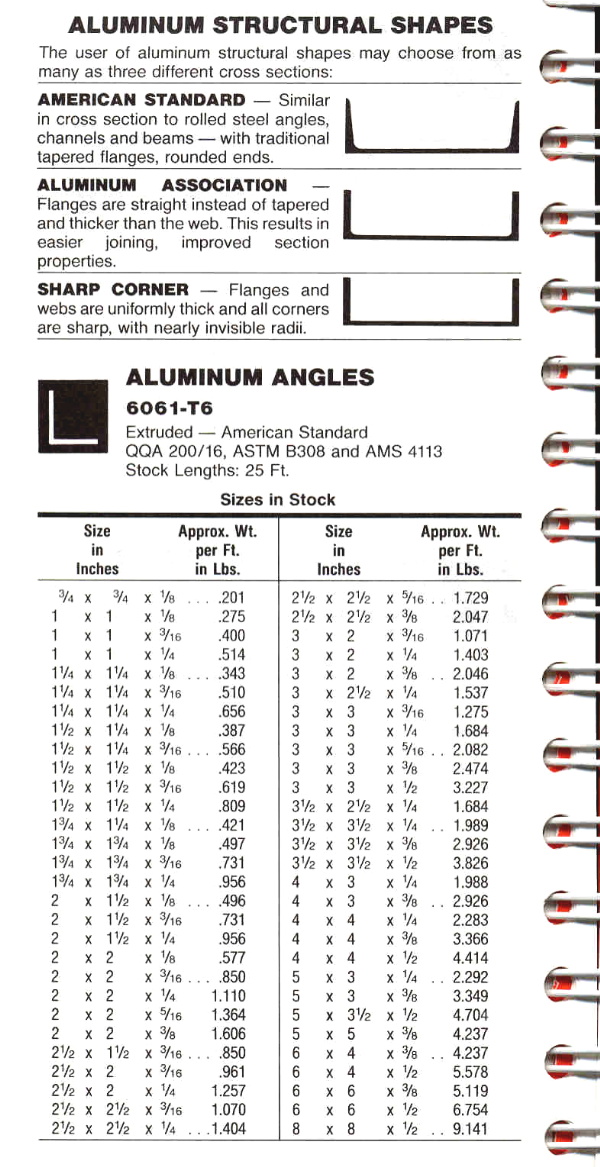

the attach photo out of the "Ryerson" stock list handbook, page 340 might
shed some light on the question concerning the angle shapes.

Hello Russell:
That is the Ryerson book I referred to in my earlier post. I did not
bring up the "aluminum Association" type as that type refers to section with
three elements, i.e. web, flange and flange. A angle section has only two
sections, i.e. flange and flange. If you compare the Ryerson drawings with
my photo of ZA furnished extrusions, the small extrusion compares with the
"sharp corner" type, whereas the large extrusion doesn't quite compare with
either Sharp corner or American Standard as the flanges or legs have no
interior taper. Again, ZA must have this made to their spec and is not
standard, but we seek further input.
As another lister has just pointed out, the "American Standard" profile
of fileted web with tapered flanges is usually referred to as the
"structural" type where the "sharp corner" type is referred to as
"architectural" type.
