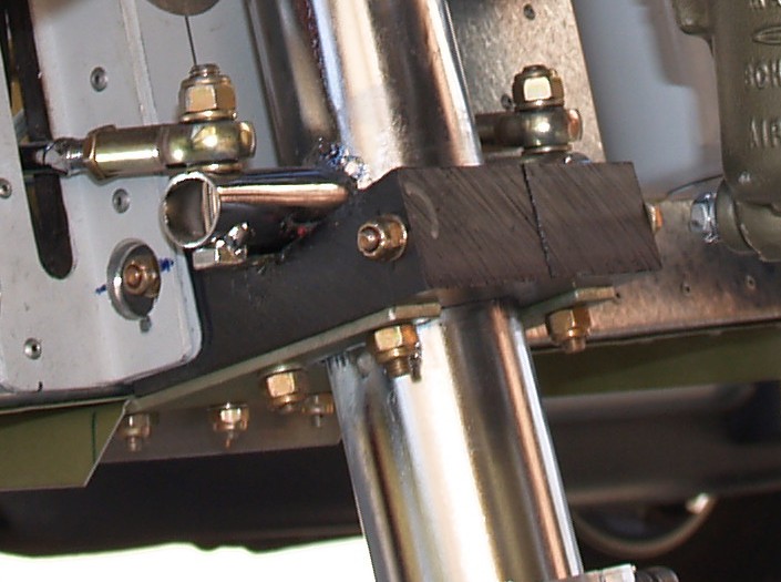

David:
I countersunk mine from the top and bolted them all
the way through with nuts on the bottom. Here's a veiw
from below showing the nuts on the bottom.
http://www.cooknwithgas.com/5_30_06_Engine_Below.JPG
The countersunk holes on top also hold some grease for
lubrication.
I don't have a closeup handy of the top.
I hope this helps,
Scott Laughlin
Omaha, Nebraska
601XL

I just did this last week and while I was doing it I felt like this was the weakest link I've installed in my aircraft to-date.
I like your idea Scott and I may go redo that next weekend. Is there anyway you can get a photo of the top side and post it?

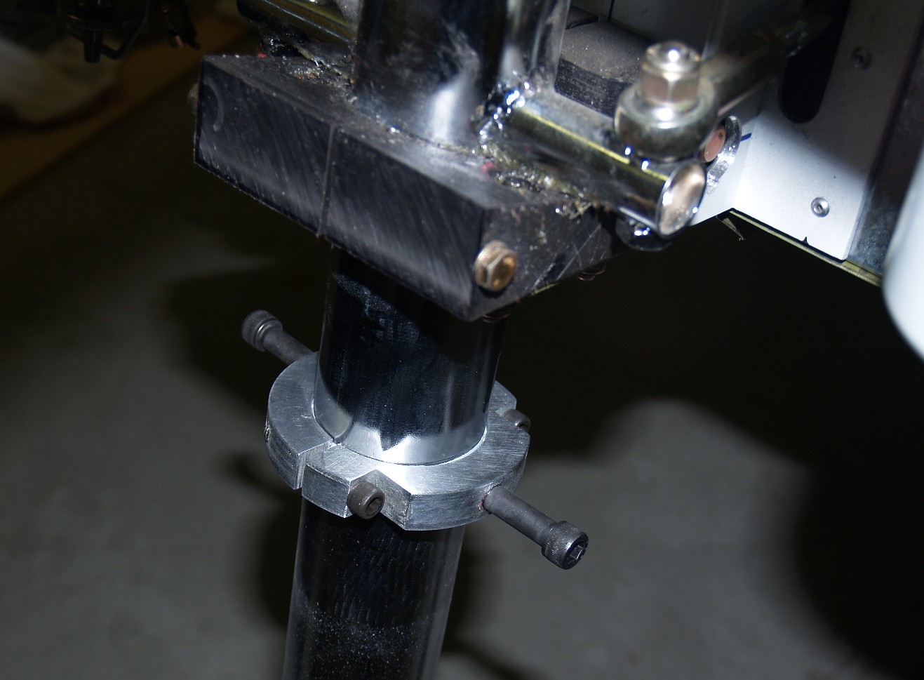

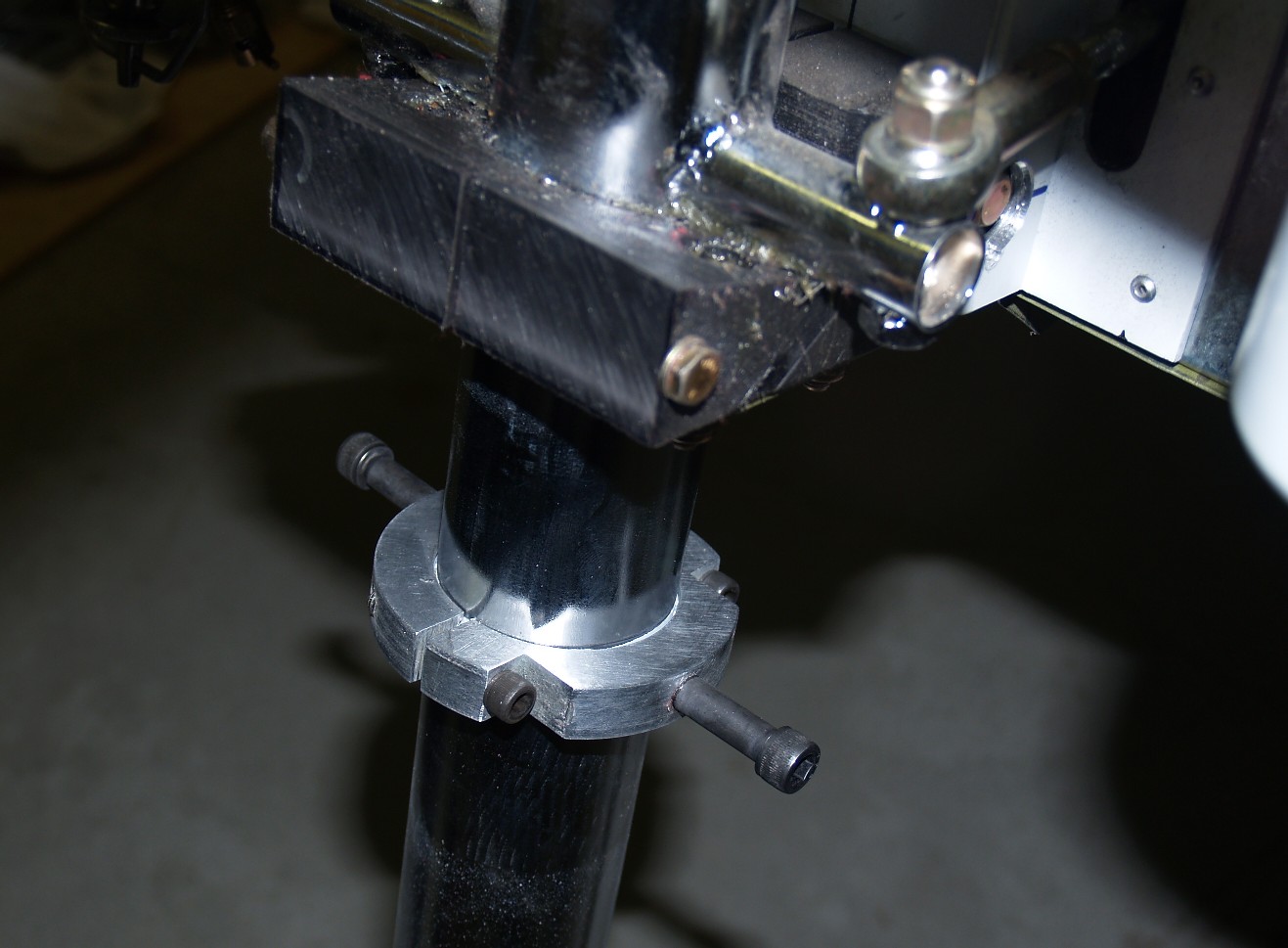

Hi Gig:
I looked through my backup photos and came up with
these two (attached). It's in a tight spot and engine
parts hide most of it these days.
Scott Laughlin
