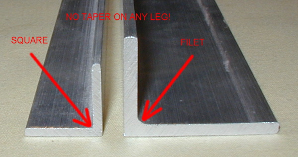

OK, now I'm at home where I have both a camera and extrusions I
purchased from ZA. This is my first attempt at attaching a photo to the
list so wish me luck. Referring to my previous posts, the 3/4 x 3/4 x .093
seems to be the "square corner" specification. There is no filet on the
inside and the legs or flanges are a constant size with no taper. The
larger 1 1/2 x 1 x .125 extrusion meets neither specification I described.
It does not have "square corners" on the inside, it has a filet, yet it has
no taper on the legs or flanges, so it really doesn't meet the "American
Standard" spec I described.
When you order from the mill in quantity, you can have any shape made of
any material made to any specification. Is this what ZA is doing?
Obviously, I don't have the complete answer. I wish I had a sample of the
"American Standard" cross section to compare what ZA furnishes.
I now believe that ZA extrusions are "mill specials" that you wouldn't
find in any normal stocking situation. That doesn't mean that you couldn't
use readily available stock sizes and alter them to "near" ZA shape.
I've done my best to determine what is the real story here, maybe other
listers can add to this story.

Your diligence is MOST appreciated. I think I will follow BN's suggestion
and return to my supplier looking for "Material Certs." Got plenty of
time...

Now, for peace of mind, may I suggest: get rid of the unknown material and
get some from a
reliable source. I don't know what is the current price of 6061-T6
extrusions, but it can't be so
high that it would justify a full scale investigation on the origins of this
piece...
