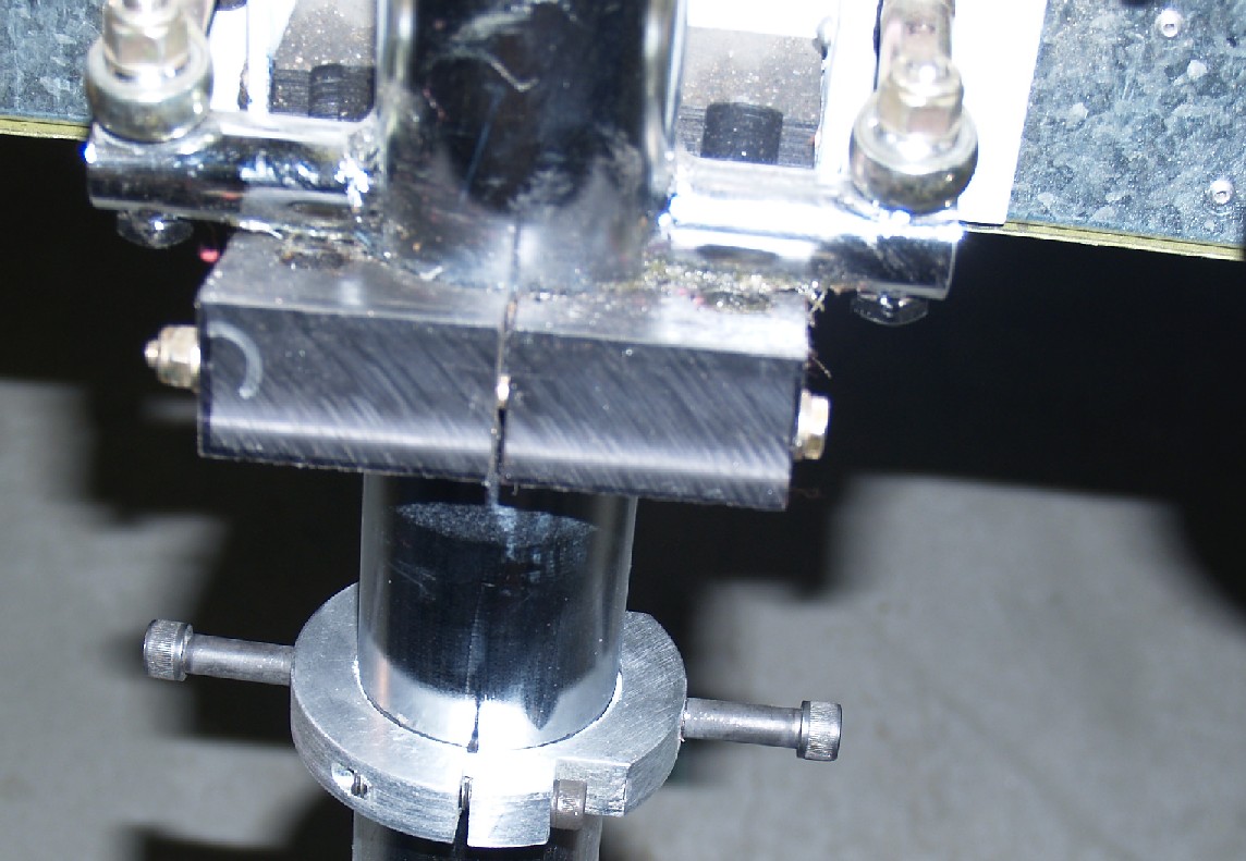

I found one more picture that is important if you plan
to go this route. The countersink for the back holes
get into the stop-block part of the bearing. This may
be difficult to do on a drill press - I used my little
mill.
Scott Laughlin
www.cooknwithgas.com
--- Gig Giacona <wr.giacona(at)cox.net> wrote:
I like your idea Scott and I may go redo that next
weekend. Is there anyway you can get a photo of the
top side and post it?
