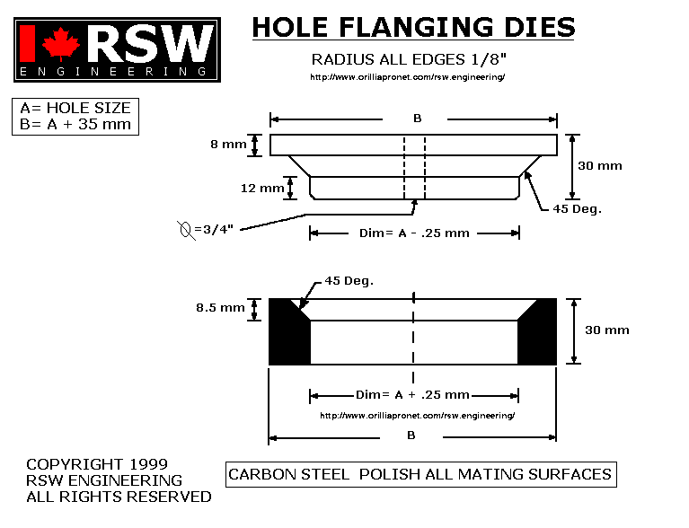

When I built my 701, I made my flanging dies from plywood as per Chris H. plans.   I used them for my 701, got permission from ZAC to use them on the 601  (plans called for slightly different size flanges) and my cousin is now using them for his 701.    Simple to make, but take a little time.  At the time (no expereince) it took me one day to make a male/female set, the second day I made two different sets.---------(now I could make them all in one day) I have friends who believe in overkill and think they have to be mechined from aluminum at a mechine shop----not so-- unless you are going into the airplane production business.

attached is a file drawing for plans for flanging dies from RSW eng. for
metal ones. But they can be made from wood as well.
The female die is fairly easy to make as one piece with a router and
mating camfer bit...if you have one and also possible with a drill press I
would guess.
The male side is easier to make as three separate flat pieces then both
glued and screwed together.
3/4 hardwoods work the best followed by 3/4 plywood.
And for us that will only use them a few times. Cheap particle board
works very well too. Mine and B. J. Swaller's are 5/8 particle board left
over from carpet underlayment jobs......with scraps of thinner plywood
mixed in. B.J. made his on a drill press.....
They don't have to look pretty to make a nice flange.
Align the dies and drill a hole threw the center for a bolt and big flat
washers to squeeze the dies and form the flange. or put in a shop press
or large arbor press.....
You get the idea........

When using flanging dies of any type, after you cut the holes, make sure you sand the inside of the hole until you can run your finger around the inside edge and feel NO nicks or other imperfections.  Any nick can cause the flange to crack while it is being formed.  I ruined a nose rib learning this lesson.
