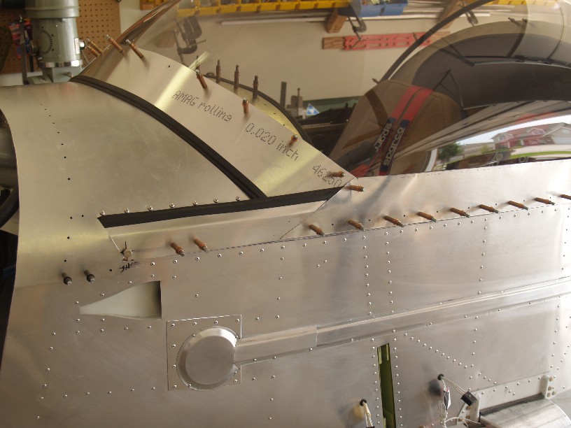

P.S. I'm attaching my Daily Pic. To everyone else -
where's yours?

We are at exactly the same place with the canopy. One of us has the
outside front cover of the square tubing on upside down. I am the guy who
lost his canopy the other day. I can't believe how ornery replacing the
canopy is.
CUL,
John

I saw the cover as being upside down also unless he is scratch building and if that's the case he more than likely made the top oversized for fit.... If not it is upside down LOL.
Jeff

That would be me with the upside down front cover. If
you look closely you will see some other things that
are different (the front flashing runs under the side
flashing). I'm trying to get a tight seal when the
canopy is closed so I'm experimenting with different
arrangements. It takes two seconds to bend a new
cover and I've got gobs of spare .025" and .020"
pieces laying around.
I may move the location of the bend to the middle and
try that next if I can't get this way to seal. Thanks
for noticing and I'm glad my picture could prompt some
discussion on this matter. Let me know your yours
fits.

Yours looks much better that way... I was thinking of making a new one because the on I got with the kit isn't tall enough IMO and if you look at some of the pic's in the photo assy. guide a few of theirs is more like yours.
Jeff
