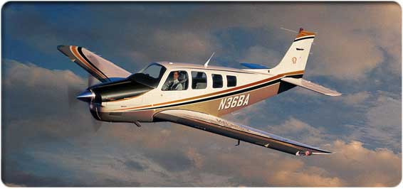

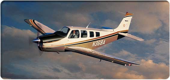

I also have Tony's overhead console installed. My install didn't go quite as easy as it sounds like your did because the plane the mold was made from appeared to have had quite a bit of sanding  work done on the canopy before the mold was made, so we had to modify it somewhat to get it to fit. I like the console and I'm not sorry I got it, but we couldn't just stick it on and go. I'm still working on sealing the back area that should abut to the baggage compartment bulkhead.
I've owned a Bonanza and a Baron and they both had air inlets around the area where Tony has his, based on the pictures, I haven't received anything yet, except that Beech has theirs on the side of the fairing. On the Bonanza I never had any problem of exhaust coming into the cabin. It would be more closely related to the 10 in that the Baron's engines obviously wouldn't be inline with the VS.
I've attached a photo of the Bonanza placement of their air inlet. Are you thinking that the exhaust will come under the plane and then swirl up around the VS area? I'm not an engineer by any stretch of the imagination, so I'm not questioning your concern, but it seems like the exhaust would travel down and back, not down and up over the VS ??
