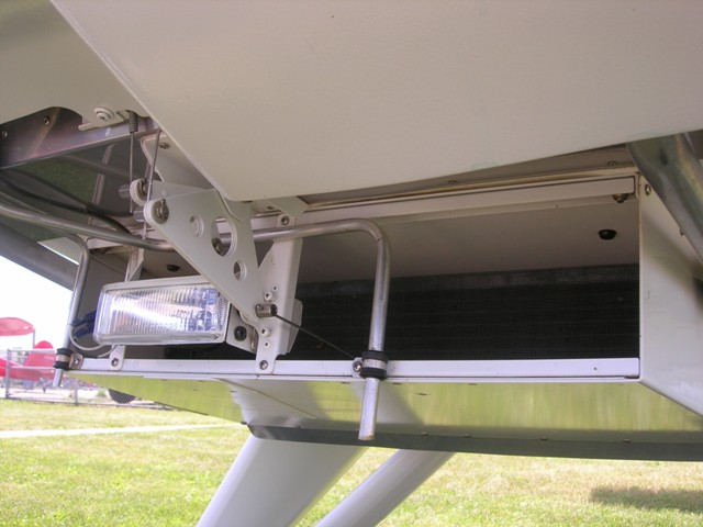

Clint,
I was just reviewing your photos I saved from 2002. Do you have a part number (J. C. Whitney) for the landing light. I also assume you have a seperate switch and circuit breaker for it? Thanks. Jeff Classic IV

Jeff,
Bill Willyard (on this list) has a pretty nice landing light - with position control. I took the attached photo at the JXN fly-in.
I don't think Bill will mind we sharing.
I don't know what bulb he used but he's pretty resourceful.
Richard

Richard,
Thanks. It looks like the one Cliff had. They do look nice. Jeff

Hi,
Just back from hospital with some back problems. I think that it came with a set of 2 and the box maybe in my hanger-garage. It did use the standard 50 watt quartz h bulb. I think it has lasted for hundreds of hours. Cost only a buck or two, carry spare. Use it in landing pattern in flashing mode. Better then strobes on final. Yes I have seperate breaker and swith. I have it aimed about 50 down the runway and works fine. Clint
