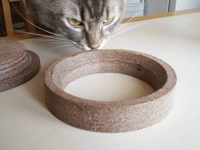

Since there's been some recent discussion about flanging dies, I thought I'd post a pic of the ones I made this morning. I've pretty much been fretting about making these since I started this project, and here's what I learned in the process.
a. They're really easy to make. I used a band saw to cut out the blanks, a wood lathe to turn the male die, and a jig saw and 45 degree router bit to make the female. I used the drawings in the Zenith builders manual as a guide. They're made out of "Timbertech" - a decking material - kinda like plastic. Took me 2 hours from waking up to testing them out with my shop press. Worked great. Perfectly flanged holes BOOM - that fast.
b. It took me a year to think about, and two hours to make. My lesson to myself is don't get caught up in "analysis paralysis" and just go ahead and make the &#!$%# things. Exercise caution, but move forward. Hasn't really been a problem with me, but a good reminder.
c. The most important tool in your shop is between your ears.

SLICK! Especially nice rodent proofing.

     It looks like they smell good too, at least to your cat. LOL
