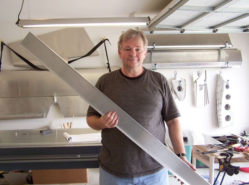

PostPosted: Mon Jul 03, 2006 10:29 am    Post subject: Rear Wing Channels (Scratch Builder Question) Reply with quote
I just made my rear wing channels today. Bent them with my trusty $75
bending brake. They turned out great. I'm going the 6 foot spliced route. If
the good folks at Can Zac think it's OK, and Zen-Master Scott Laughlin
thinks it's OK, and most importantly, if Chris Heintz thinks it's OK...then
its OK with me.
If anyone is interested I can email you step by step instructions (with
photos) showing how I did this task.
Dave

PostPosted: Mon Jul 03, 2006 12:45 pm    Post subject: Rear Wing Channels (Scratch Builder Question) Reply with quote
Wow Dave! That picture looks like you came to my
garage and cleaned it up and took that picture! Mine
used to be that clean but somehow it got messy and I
can't bring myself to stop and re-organize it before I
finish my airplane.
Your rear channel bend looks great. I think the
spliced channel is stronger than the 12' version since
you reinforce the channel right where you drill the
big hole for the aileron control rod. Chris H. is
good with it and I have a sketch from him to prove it.
Just to be clear, the splice is a mini-channel that
fits inside the flanges of the channel, not just a
plate. It's a tricky bend to get just right so get
some scrap pieces ready for trial and error.
