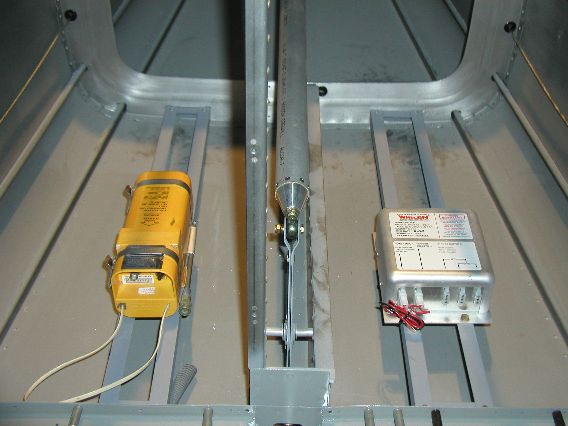

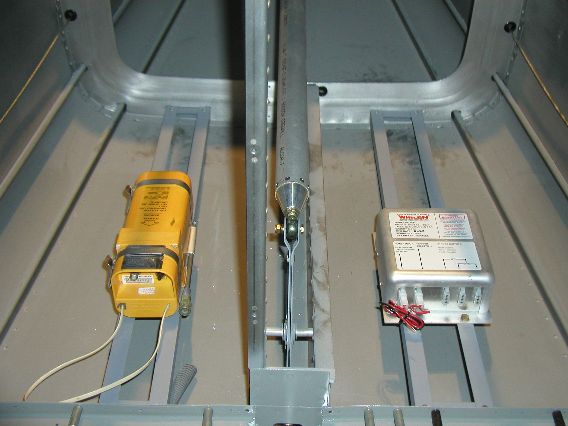

Obviously not a direct answer to your question, but why not mount it between
the battery box and the fuel selector? Make a little shelf between two of
the floor stringers and put it on the shelf. This is also a good location
for your ELT, oxygen bottle, or fire extinguisher.

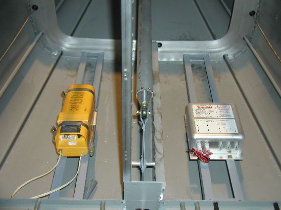

bobbyhester(at)charter.ne
PostPosted: Sun Jul 02, 2006 7:16 am    Post subject: mounting strobe power supply in RV-6/6A Reply with quote

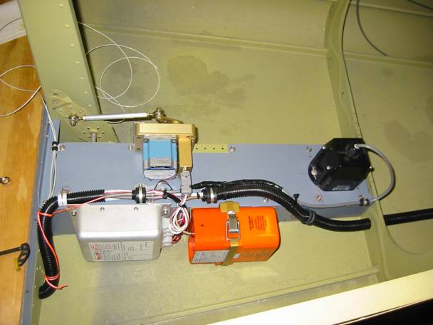

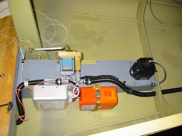

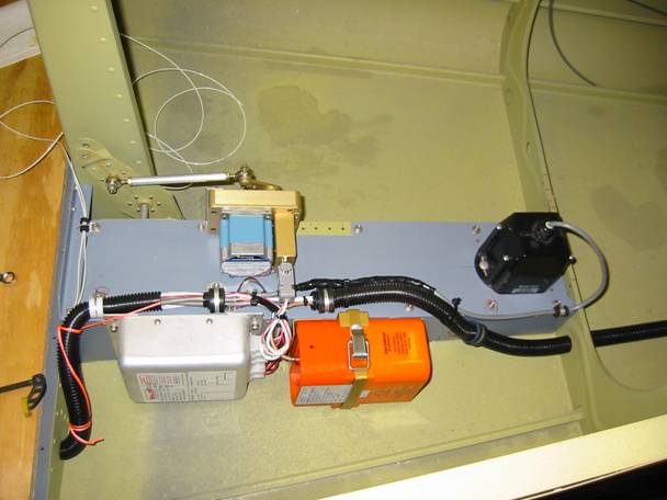

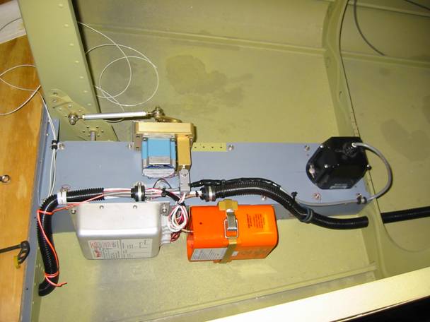

Here's what I did, I had it on my web site at one time but have since removed some of the older stuff:
[img]cid:part1.06070105.05090509(at)charter.net[/img]
I ran conduits under my baggage floors to run wires.
My new email address: bobbyhester(at)charter.net (bobbyhester(at)charter.net)
Surfing the Web from Hopkinsville, KY
Visit my web site at: http://www.geocities.com/hester-hoptown/RVSite/
RV7A N857BH SB wings-QB Fuse-XPO360 engine Smile

Yes, that's a good location, functionally, but likely to get
kicked. I'd want to make some sort of cover for it (there's 5000v in
one of those wires). Besides, I plan on putting the fire extinguisher
there. Also, the wires from the strobe supply have to end up on the aft
side of the wing spar, so it's convenient if they start out on the aft
side of the wing spar to begin with. That ay only the power & ground
wires cross the spar.

Mine went on the aft side of the baggage bulkhead, slightly left of
center and just below the seam between the two halves of the
bulkhead . It has worked well. Now that I have done many
inspections, mods and maintenance I would recommend putting it on the
top half bulkhead. Reason being that I have not had the need to
remove that one in the last several years. There fore I would not
have to unplug the power wires each time I take off the bulkhead for
inspections etc.
I also like Bobby Hester picture, since that belly skin is an oil
canner and those rails should stiffen them up a bit!
Denis Walsh

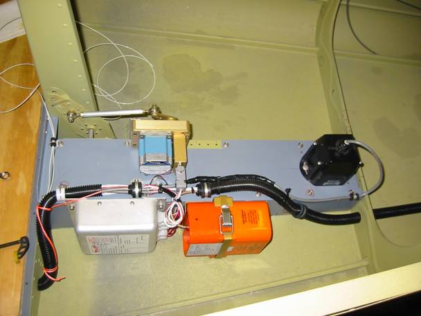

bicyclop(at)pacbell.net
PostPosted: Sun Jul 02, 2006 5:01 pm    Post subject: mounting strobe power supply in RV-6/6A Reply with quote
Hmmm, I don't think that will help with oil canning. It looks as if the rails are suspended on each end at the bulkheads and not in contact with the skin. I bought another rib from Van's - the one that the elevator bellcrank is mounted to (sorry I don't have the part # at my fingertips) and fit it parallel to the existing one and made a sort of avionics deck.
Things wound up crowded and I mounted on the side of it. That black thing at the aft end is a remote compass sensor which I’ll probably end up not using.
Pax,
Ed Holyoke

It's got a mounting plate that is about 6" square. It weighs 2
Lbs.  I want to mount it just behind the baggage bulkhead some
where.  First idea, to simply mount it to the belly skin was
rejected.  The skin's not braced enough.

sheldonb(at)frontiernet.n
PostPosted: Mon Jul 03, 2006 4:02 am    Post subject: mounting strobe power supply in RV-6/6A Reply with quote
Ed, Just some information for you... I have the AK-450 ELT as you do... The mount for the mounting strap broke (at around 300 hours)... Not sure why, but might be from unhooking it and re hooking at battery change times or from viberation... you might think of beefing this up... for if it came loose back there... not good...!
Sheldon RV6A 400 hrs
 Filesize:  30.84 KB
 Viewed:  555 Time(s)
PostPosted: Mon Jul 03, 2006 8:18 am    Post subject: mounting strobe power supply in RV-6/6A Reply with quote
Sheldon,
Thanks for the heads up. This airplane isn’t flying yet, but I’ll make sure to put a line in my inspection checklist to give it special attention when it does.
Pax,
Ed Holyoke
