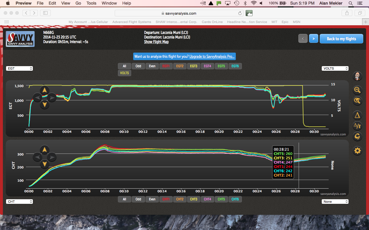

I have AFS 4500 in my RV10.Today I took a short 30 min local flight. Taxing in I got a check volts audio alert. The volts suddenly dropped from the usual 14.4 to basically zero. See below in the upper graph in yellow (volts ) at 29 minutes. If the alternator quit I should read the battery voltage not 0.
Any ideas on what to check?
Alan

Probably a failure at the battery ground, or master relay solenoid.
You are right that alternator failure would not cause you to go below
battery volts.
Do you have battery backup on your EFIS or did it also quit at that point?

It could be the breaker/circuit that supplies the voltage sensing has popped. I'm not sure on that unit if it is the power supply line to the EFIS or if it is a separate voltage only line, in which case that wire could be broken or could have been cut or shorted to ground.

I noticed no changes in the EFIS. They have backup battery. It was a sudden failure as you can see.

I just peeked at the wiring diagrams.
eFIs Expansion cable Pin 13 is labels as Volts2, but I don't see a volts1 anywhere. There are two power inputs into the main connector. It is possible that one of them monitors voltage and one doesn't. Possibly one of the came loose. Call advanced and they'll have the answer quickly.
