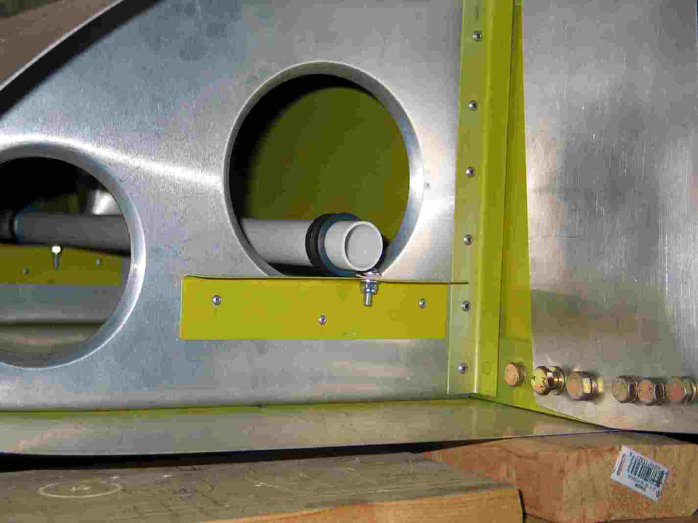

Michael,
You can always use lightweight PVC conduit to be sure that the wiring stays
in a safe place. I attached mine to brackets on the ribs with adel clamps.
The big benefit is that you can postpone the wiring until later in the
build. It's also very easy to change wires without unzipping the wing skin.
(Photo Attached)
Graham Kirby.
601HD

Nothing wrong with that as far as I can tell. I chose to use thin wall .5"
I.D. aluminum tubing for conduit. I suspended it from .025 aluminum strips
with a rubber grommet for the tubing. The strips are attached to the rear
ribs with 2 A4 rivets each and they hold the conduit suspended in the
forward lightening hole. At each end I used about 4 inches of .5" O.D. clear
fuel line split and wrapped around the bundle of wires to prevent chafing at
the edge of the conduit. Probably more complicated than it needs to be but I
won't ever worry about how things are going inside that wing and I can pull
new wire if I ever want to.
Ed
