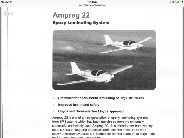

Ampreg 22, not approved by Europa??
tonyrenshaw268(at)gmail.c
PostPosted: Tue Nov 04, 2014 12:05 pm    Post subject: Ampreg 22, not approved by Europa?? Reply with quote
Ironic,
Unless things have changed, to my knowledge it is still not approved by Europa.
TR

PostPosted: Wed Nov 19, 2014 1:48 pm    Post subject: Re: Ampreg 22, not approved by Europa?? Reply with quote
Confirmed in a telephone call to AD at the UK's LAA a week or two ago, West Systems 105/205 would seem to be approved - MOD74 instruction leaflet top of page 2 refers:
". . . acceptable alternative structural epoxy resin systems may be used. Some suitable alternatives are Schueffler L285/H286, West Systems 105/205 and Aeropoxy PR2032/PH3660. The use of materials other than those listed above
will require approval from Europa Aircraft."

PostPosted: Wed Nov 19, 2014 4:45 pm    Post subject: Ampreg 22, not approved by Europa?? Reply with quote
Schueffler L285/H286 is the best of the buch. Much more user friendly, less toxic, better wetting
and it's approved for certified aircraft.

PostPosted: Wed Nov 19, 2014 7:39 pm    Post subject: Ampreg 22, not approved by Europa?? Reply with quote
Thanks Graham,
I will see if it the Schueffler is available downunder. A little shocked Ampreg 22 can have a Europa formation on the Technical Data Sheet but not be approved.
Tony R.

PostPosted: Thu Nov 20, 2014 2:48 am    Post subject: Ampreg 22, not approved by Europa?? Reply with quote
Tony
It's available in the USA as MGS,
Graham
1-877-773-7336 | sales(at)compositescanada.com (sales(at)compositescanada.com)
MGS Epoxy 285 + Hardener H285/H287
Low viscosity, low toxicity laminating resin approved by the German Federal Aviation Authority. Excellent mechanical and wet-out properties. Will not spill out from fabric on vertical surfaces. Will maintain mechanical properties up to 210 F if post-cured. Mix ratio is 100:50 by volume and 100:40 by weight. Hardeners 285 and 287 can be blended to obtain optimum working time. Working time (at) 20 C = 2-3 hours (285) or 5-6 hours (287). Sizes: 1.5 gallon kit, 6 gallon kit.
