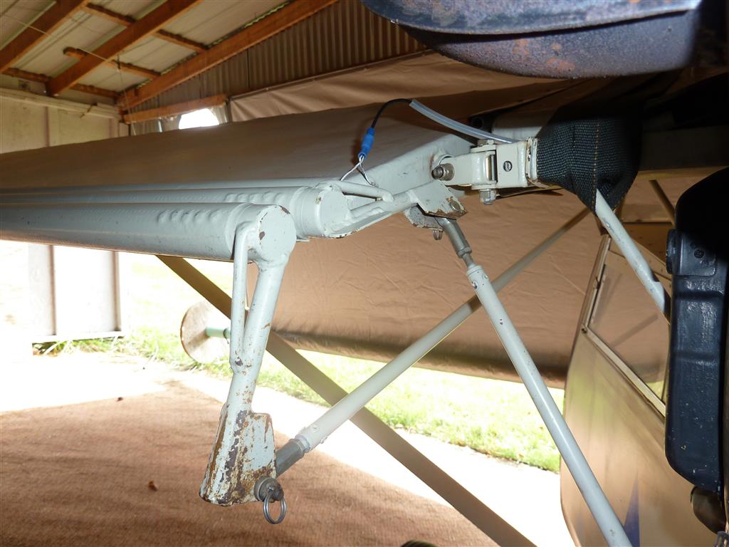

Hello Kolb World,
I am in need of a picture of the rear inboard corner of the Mark IIIC wing. I need a view of how the aileron tube and flap tube a line behind the wing trailing edge tube, and what angle the horn is set at. I am building a hybrid wing for my Kolbra and realized that I do not have this view in a picture or the different plans that I am working off. I was unable to tract down Travis today. If anyone can post a picture, or a copy of the plans for this, I would be most grateful.
Nick Cassara

Here ye be. Flaps are up and aileron mostly level. (And yes, getting rid of the surface rust and repainting the horns is planned for this winter...)
