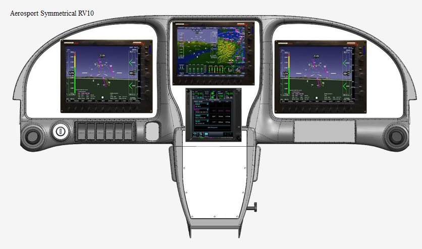

There isn't a way to fit a 750 and an AFS5500 (let alone another 10" display) in the center panel of the Aerosport symmetrical panel, without doing some custom fiberglass or carbon fiber work.But... does it look nice, heck yeah!
This is close to the general setup I'm trying to figure out. I want a full MFD in the center, as I don't want to have to reach over to the co-pilot side for mapping, flight planning, weather, etc. If I were doing two screens, I'd probably leave out the co-pilot screen over the center screen, and replace it with something like an iPad.
[img]cid:ii_149a4ed5f66994b1[/img]

I like the layout,it's what I was originally thinking but I don't think the 750 would fit that low without major reinforcement of the second bulkhead? Haven't looked that far into it though.
Originally my thoughts about the screen in front of copilot but with the touchscreen it's just a swipe of the screen to display different screen modes from what I understand.

There is a thread on VAF that discusses symmetrical vs side by side that is
worthy of a read.
http://www.vansairforce.com/community/showthread.php?t=116936
From what I've heard you won't use the far right screen much at all so I'd
somehow put the 2nd EFIS in the center. If money were no object I'd throw a
3rd screen over on the copilot side as well. As for a backup instrument I
went with and prefer the Dynon D2 up on the center post similar to Rob
Hickman's because I felt that relying on the screen in front of the copilot
as the backup would be difficult at best. I've also been told that the
backup in the lower left of the panel is very hard to see.
-Ben
Tim Olson
Joined: 25 Jan 2007
Posts: 2882
PostPosted: Thu Nov 13, 2014 9:43 am    Post subject: Panel planning Reply with quote
Hey Ben and all,
I have 3 screens, with 2 shifted to the Left (one is near center),
and the 3rd is center of co-pilot. I like the arrangement a lot.
Both pilots have easy access to the center screen (MFD) and the radio
stack. I don't/can't utilize the buttons very much on the far
screen without a bunch of stretching, but in my case, that's not
needed anyway.
But, the one thing I had to add is, I fly very often off of the
copilot screen. I don't find it hard at all. Now, if I had to
do a lot of button manipulation, it wouldn't be much fun,
but, as far as using it for flying, it really isn't bad at all.
So I feel that a backup EFIS functioning as backup gauges actually
works pretty well over there. It's more comfortable than if you were
having to look down to the low part of the pane in front of you,
in fact...or especially lower left.
The button pushing is the only part that I'd worry much about.
If you're using a 2-screen EFIS, I think it would be much better
to probably put one on the pilot side, and at furthest, put
the 2nd one in the center, if you're planning a lot of single-pilot
use, or planning to actually hit buttons on that 2nd screen.
A 2nd screen over by the co-pilot that needs to be physically
touched by the pilot is going to be very uncomfortable.
With 3, you have the best of all worlds.
Tim

Was originally thinking 750 over 650 because of gaining a display and the features of the 750. Since learning the remote non Garmin devices can't be controlled 2 way via Garmin display-- audio panel, Nav, transponder, etc, I'm leaning back toward the 650 but still learning the differences between the two.
I would think the middle display could be independent of the other two displays in case of TU failure so not sure why a Dynon display would be necessary unless middle display is tied to Afs hub and not truly independent.

Here's my experience and thoughts from having installed 3 GRT HXs in my '10.  Flying 3 years.
  • I used Stein's aluminum panel with a middle section angled towards the pilot seat.   I have 1 unit centered for the pilot, one center on an angle and 1 centered on the co-pilot.
  • For normal ops, the pilot has a PFD/Map split screen, the center is 100% engine, the co-pilot is for my co-pilot.
  • For Map work, I flip the center screen to 100% Map.   Without the angle panel, this would be much less desirable.  If the angle panel was not available, in retrospect I would not have installed them symmetrically because the center panel is 'too far away'.  Instead I would have bunched the 2 screens over in front of the pilot (with the 3rd centered for the co-pilot.)  I've seen pics of people who have bunched them like that on a flat panel.  It doesn't look as good aesthetically but would work much better than 3 part symmetry on a flat panel.
  • For backup/redundancy I have an ADI, ASI, Alt and AP in front of the pilot below the screen.  If I lose the screen I would immediately go to those.  If possible, I would then transition to the middle panel.  I don't think I could hand fly in the soup using the co-pilot screen... at least that wouldn't be a planned alternative.
  • iPad:  The reality of my flying since my days in gliders and a Maule is that the latest and greatest portable units will always be ahead of the panel installed last year.  I had a GNC 300XL but the G396 quickly became the go-to device for nav and wx and general reference.  In the '10, the G430W provides the WAAS smarts, the GRT displays and integrates,  but the iPad running Foreflight is the go-to device for nav, wx and general reference.  Accordingly, the G396 was RAM mounted to my Maule panel and the iPad is RAM mounted to my center console.  Where and how is your iPad going to be mounted?
The only thing I'm absolutely convinced of is that there is no single optimal solution... perhaps short of G999

PostPosted: Thu Nov 13, 2014 7:21 pm    Post subject: Panel planning Reply with quote
I think one of the keys to the backup gauge situation is to
be honest with yourself and your abilities. Going with a 2nd
manufacturer of EFIS is an OK idea, if you use it as a backup
gauge system. When the stuff hits the fan though, I'd be
willing to bet that most people won't remain IFR current and
proficient enough in running 2 systems as full approach systems,
if they want them while IFR. So personally, I'm more concerned
with having a backup EFIS or backup gauges (either is fine) that
will primarily be there to help me keep the plane:
Right-side up
At the right altitude
Headed the right direction
Yeah, I have a GNS480 and I can load an approach in it (if I've
practiced recently), but if I lose my primary system, I'm
probably realistically going to contact ATC and have them give
me the hand that I really need.
Long ago I had to decide....do you want two systems, or
do you want to build one good one that you trust. I really
believe that you're better off building one good solid one.
Now, that's not saying that for a backup EFIS, such as a
GRT mini or something small, you shouldn't just buy one and
stick it in. You SHOULD have some sort of backup attitude
indication, altitude indication, and heading indication. But
just be honest with yourself as to what you're really going to be
able to do when you lose that primary system. It takes more
work than you'd think, to stay proficient as a weekend pilot.
That's why I wouldn't bother going with a dual garmin G3X
system, and add in a big AFS, for instance. There is too
much buttonology to have that be fun at all.
Tim
On 11/13/2014 6:57 PM, Kelly McMullen wrote:
Having a different manufacturer for one of the EFIS is a mixed bag,
IMHO. Having to know two different menu logic/screens during a high
stress period isn't a good idea. I'd lean toward a mini-EFIS from same
vendor that uses same menu logic if you aren't comfortable with dual
EFIS, dual ADAHARS, dual backup batteries. We each have to decide level
of redundancy we are comfortable with. Years ago I flew IFR with one
flip flop nav com, one ADF, transponder and venturi vacuum powered AN
gyros with an electric turn and bank, with no auto pilot of any kind.
Just a handheld navcom for backup/second nav. No GPS, no Loran. That
isn't my comfort level today.
On Thu, Nov 13, 2014 at 12:48 PM, Bob Turner <bobturner(at)alum.rpi.edu
<mailto:bobturner(at)alum.rpi.edu>> wrote:
<bobturner(at)alum.rpi.edu <mailto:bobturner(at)alum.rpi.edu>>
There have been a couple of reported cases of a software failure
which simultaneously affected all screens made by the same
manufacturer; so some (including me) have opted for a different
manufacturer (to assure different software) for a back up EFIS. How
you assess this risk is of course up to you.
Bob Turner
RV-10 QB
http://forums.matronics.com/viewtopic.php?p=433614#433614
et="_blank">www.aeroelectric.com
sbooks.com" target="_blank">www.buildersbooks.com
rget="_blank">www.homebuilthelp.com
rget="_blank">www.mypilotstore.com
="_blank">www.mrrace.com
le, List Admin.
target="_blank">http://www.matronics.com/Navigator?RV10-List
">http://forums.matronics.com
dlm34077(at)gmail.com
PostPosted: Fri Nov 14, 2014 6:16 am    Post subject: Panel planning Reply with quote
For IFR, I think two independent systems are necessary. My Chelton system with two displays has a complete AHRS and GPS system; my backup is a GRT Sport SX with AHRS and GPS, the tie breaker is a Trutrak Digiflite II with its own solid state gyroscopic capabilities. There are three different ways to keep the clean side up. The AP can be used with each EFIS (LNAV,VNAV) with the Cheltons, LNAV with the GRT and stand alone. The SL30 output for the VOR/LOC/ILS is sent digitally to both EFISs. The backup EFIS has power inputs from both the primary and essential busses. The Cheltons and the Trutrak are powered from the essential buss. The original plan was two 680s in parallel for starting and backup but due to a requirement for a little more forward CG, I added a 680 to the firewall and insulated it. It provides ground power and is isolated from the starting circuit of the essential buss. With the engine running and the alternator providing power, the primary and essential busses are one.
From a practical stand point if you have an EFIS failure while IFR, the failure must be reported to ATC; it is very reasonable to declare and use their assistance to put the aircraft on the ground safely. From a practical standpoint, The primary Chelton is the PFD, the secondary Chelton alternates as MFD during flight and engine data during landing and take off. The backup has a page for MFD with airspeed, altitude, traffic and weather. If the primary fails the backup has three important buttons, PFD,MFD, or engine data. Of course there are lots of split screen possibilities but in an emergency, simple is better. I plan to use it as a PFD which includes engine data; I expect to land at a large airport, if possible, with fire rescue equipment. I obviously would use the AP to keep the wings level while attending to other duties. I find that the things I consider in the planning never seem to happen. Also since the GRT Sport SX has the synthetic approach capability, I have two means of an ILS approach guidance at hand, the crosshairs (from SL30 data) on the Sport and the internal GPS HITS which overlay the ILS.
Each must be comfortable with one's own plan. I too learned and hand flew much IMC with round gauges but early on I added an electric AI and a Strikefinder to my C177RG. Now my comfort level requires more.
Kellym
Posts: 1706
Location: Sun Lakes AZ
PostPosted: Fri Nov 14, 2014 7:11 am    Post subject: Panel planning Reply with quote
I'm curious, since I know of very little data on the subject. How many
of you have experienced, or know of an EFIS problem from a software bug
in the past say 3 years? During the early years of experimental EFIS
systems I'm sure the concern of dual EFIS having dual failure from
software bugs was a real concern. At least one vendor recently asserted
to me that it really isn't a problem anymore. I've seen nothing to
support either side of the discussion. That said, I'd sure want to put
some VFR testing time behind any firmware revision before launching IFR
to depend on anybody's EFIS.
Kelly McMullen
KCHD
Tim Olson
Joined: 25 Jan 2007
Posts: 2882
PostPosted: Fri Nov 14, 2014 7:33 am    Post subject: Panel planning Reply with quote
I'm sure bugs exist, but I haven't found any in years, actually.
A hardware problem is much more likely. But, some systems, like mine
and many others, are actually independent CPU's for each screen, so
something that affects one doesn't affect all the others.
I don't disagree with having items from two manufacturers, but
I also don't think that having 2 dis-similar units from one manufacturer
wouldn't accomplish the same thing. In the end, the most important
thing I think is that you have a reliable primary system, and
purchase at least some form of backup system, wether it be EFIS or
round gauges. Once you have that, I see no problems regardless
of the manufacturer of each.
I'm weighing the options for my RV14 build now too.
I'm thinking an RC Allen round Attitude indicator (I believe they
may be coming out with one with airspeed and heading built in)
would be plenty for me for a backup.
Other choices are the GRT mini, or round gauges.
Certainly I'm not going to waste a ton of panel space on it.
I'd prefer to keep it to a 2.25" round gauge if possible.
Once you have a good actual instrument as a backup attitude/
altitude/heading indicator, I think the iPad makes a pretty
good backup navigational device, and with 4 iphones and
4 ipads in the family, I'm not too concerned with having one
available.
Tim
bill.peyton
Joined: 19 Sep 2010
Posts: 198
Location: St. Louis, MO
PostPosted: Sat Nov 15, 2014 2:25 am    Post subject: Re: Panel planning Reply with quote
Early on I had full and selected EFIS failures and reboots multiple times, one specific one in full IMC. I fully believe that those software bugs have been found and fixed, and I have not had one in over a year 250 hours. So yes, they happen. Don't kid yourself. I agree with Tim, I frequently practice approaches and hand flying with just the backup D6, and it is extremely difficult to fly the plane and set up the GPS to shoot an approach due to the panel layout, D6 way over on left. If it happened for real in IMC I would have approach vector me. So define your mission and then define your panel around that mission.
Bill
WA0SYV
Aviation Partners, LLC
Mauledriver(at)nc.rr.com
PostPosted: Sat Nov 15, 2014 6:44 am    Post subject: Panel planning Reply with quote
Zero failures or problem from bugs on my (3) GRT HXs - 3 years and 500+
hours. Plenty of IFR.
I don't care for the dual brand EFIS thing either. I use an ADI and
some small round guages for basic backup, I can keep it upright with
that. The Trutrak AP is a very capable backup as well. Though the 3
systems run the same software, they do run independently from a HW
failure standpoint. Dual Batts, dual alts, dual bus, dual AHRS, 3
screens and 3 or 4 GPSs feels good. Having the juice to run the
doo-whizzies is pretty important.
bug in the past say 3 years? During the early years of experimental
EFIS systems I'm sure the concern of dual EFIS having dual failure
from software bugs was a real concern. At least one vendor recently
asserted to me that it really isn't a problem anymore. I've seen
nothing to support either side of the discussion. That said, I'd sure
want to put some VFR testing time behind any firmware revision before
launching IFR to depend on anybody's EFIS.
