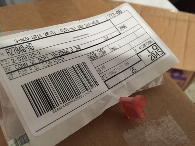

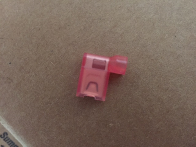

What tool do you use to crimp these?
jskiba(at)icosa.net
PostPosted: Thu Nov 06, 2014 7:05 am    Post subject: What tool do you use to crimp these? Reply with quote

PostPosted: Thu Nov 06, 2014 8:09 am    Post subject: What tool do you use to crimp these? Reply with quote
Those are affectionately referred to as "flag terminals", so if you have a
ratcheting crimper with removable jaws, sometimes you can get a set of jaws
for flags, otherwise do a quick google for flag terminal crimper and you'll
find lots of options. That said, if you are careful (and depending on the
brand of flag terminal), sometimes you can use a regular terminal crimper
for them with good success.
